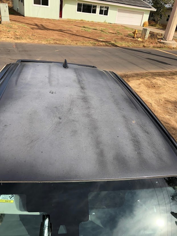

    I had a second gen in black sand pearl color that stayed shiny for the first 12 years. Then one August I had to go on a business trip and left it with the windows up sitting outside in the Southern California desert sun for three weeks. When I came back, the roof had that rough feeling and upon close inspection it was crazed and cracked right down to the metal like a dry lake bed in the desert. It didn’t look bad at first, but it had a rough feel when I washed it.
    It soon after started to look like yours, but I didn’t do anything about it for another year and it started to rust. Sanded it primed it repainted and re-cleared it (which was a lot more work than I expected) yet the rust is starting to come back in tiny places now despite a lot of careful prep work.
    I would demand Toyota fix it and make a stink if they don’t because that’s not right after just 2 years. And complaining is a lot less work than the sanding and painting project will be!

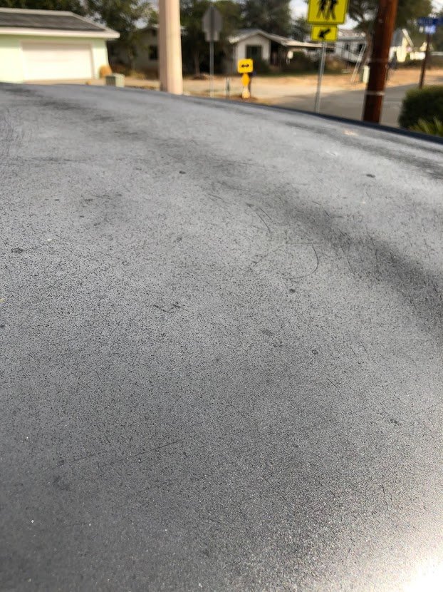

    Two dealerships, and many toyota corporate letters/ emails/ calls later (with pics and estimate from a certified toyota collision center, $5,000), they won't cover it. Truck is within the two year bummer - bumper warranty but.....(drum roll)....the millage just past the ever so critical number of 36,000. I should have took it in when I first noticed that little "rough patch" many months ago. Sucks for me. :(

    I think a first start is to find a paint shop that has a mil gauge. They can see how thick the paint is. If its factory thickness, then you can push it. If it is thicker than factory, then that indicates it has been repainted at some point and your SOL.
    No point in blasting toyota and getting attorney involved if toyota checks the paint thickness and it indicates its been repainted.

    Thats awful. Looks like 20yo paint! There is no easy fix there. That is a sand and repaint.

    it looks like someone sanded your roof or something. It looks so bad. If I were you I would get it wrapped instead of painting it. it'll probably be cheaper and hold up better in the cali sun

    I don’t see the logic in paint being a mileage issue. In fact if u really think about it , when the truck is driving around it’s not just sitting parked baking under the sun on one side lol .
    I have a feeling because it’s CA , we are the first wave of trucks to see this paint issue come up . More time will probably see it a lot more.

    Update :
    After many many many trips to the dealer and multiple calls to Toyota corporate they at last acknowledge it’s obviously a factory defect. They are replacing the whole hood and replacing the roof. I also believe they are going to repaint the whole truck .
    Initially their defense was although it was only 2 years old it had 42k miles and was out of warranty. The damage was a result of “solar convergence” (their words)... also know as the sun lol. We didn’t accept that and kept pushing for months until supposedly more owners of mgm grey Tacoma’s had the “same issue”. Soooooo ya. No color is safe , but at least Toyota will think about fixing it. That would be cool if trucks were stainless steel with no paint , like that giant arch in St. Louis . Seems like it’s held ok for that long ...
