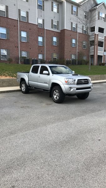

    Here's a picture

    A picture of the actual suspension will tell us what kind of lift.

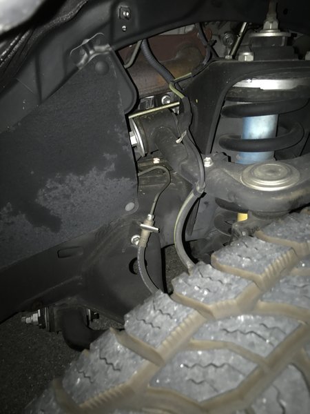

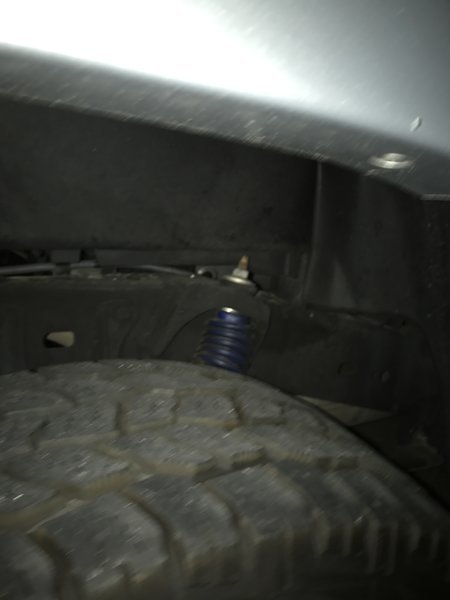

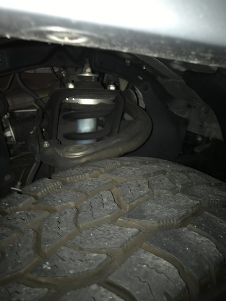

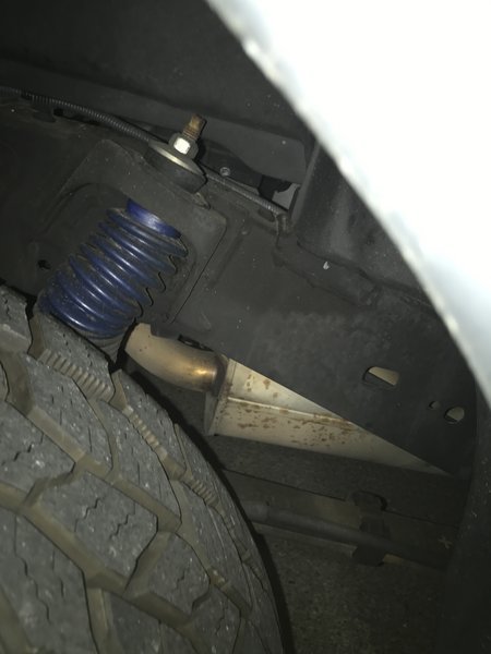

    Does this help?

    That's a pretty small top mount spacer. That's not going to make it ride any rougher. The way your truck rides is likely the way any other Tacoma rides without extensive suspension work.
    Cough up some cash for a decent suspension or accept the way it currently rides. I did the former. Jury is still out if it was worth it, but the ride is much better.

    I had something similar on my last truck and that along with overinflated tires, it made for a pretty rough ride.
