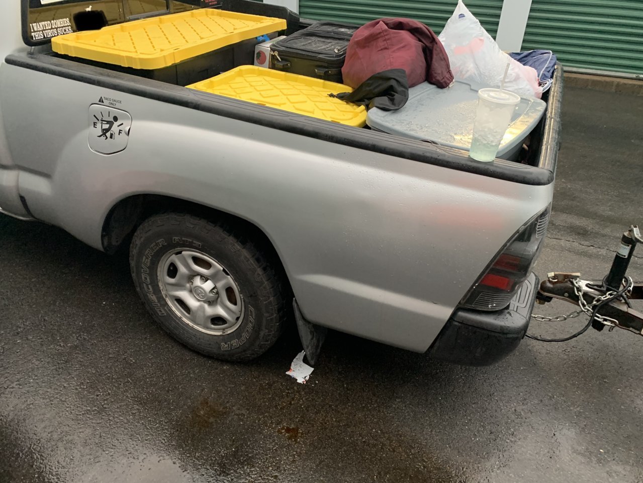

    I pulled a 16-foot trailer with my 2.7L/auto last spring. From the factory, my truck is rated at 3,500 pounds towing capacity, and with the add-a-leaf kit it's probably a bit more. The trailer weighed just under a thousand pounds empty, and combined with the trailer cargo and the load I had in the bed, I was probably around 1,500 pounds. My truck would not go past 30 MPH going up one particularly steep hill with that trailer, but other than that towing was effortless for a 4-banger with almost 170K miles (at the time); I just set the cruise control on the highway and comfortably did 55-70 MPH. My truck even averaged 17 MPG pulling that trailer!
    No, I do not think that the 2.7L is too weak to do what you're planning to do...

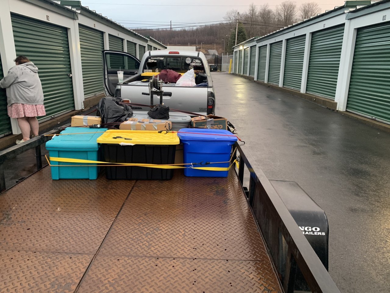

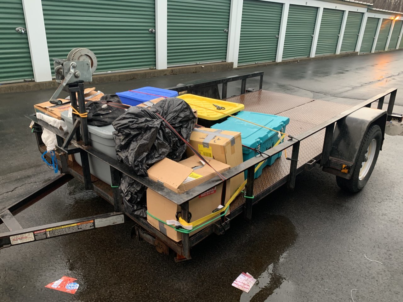

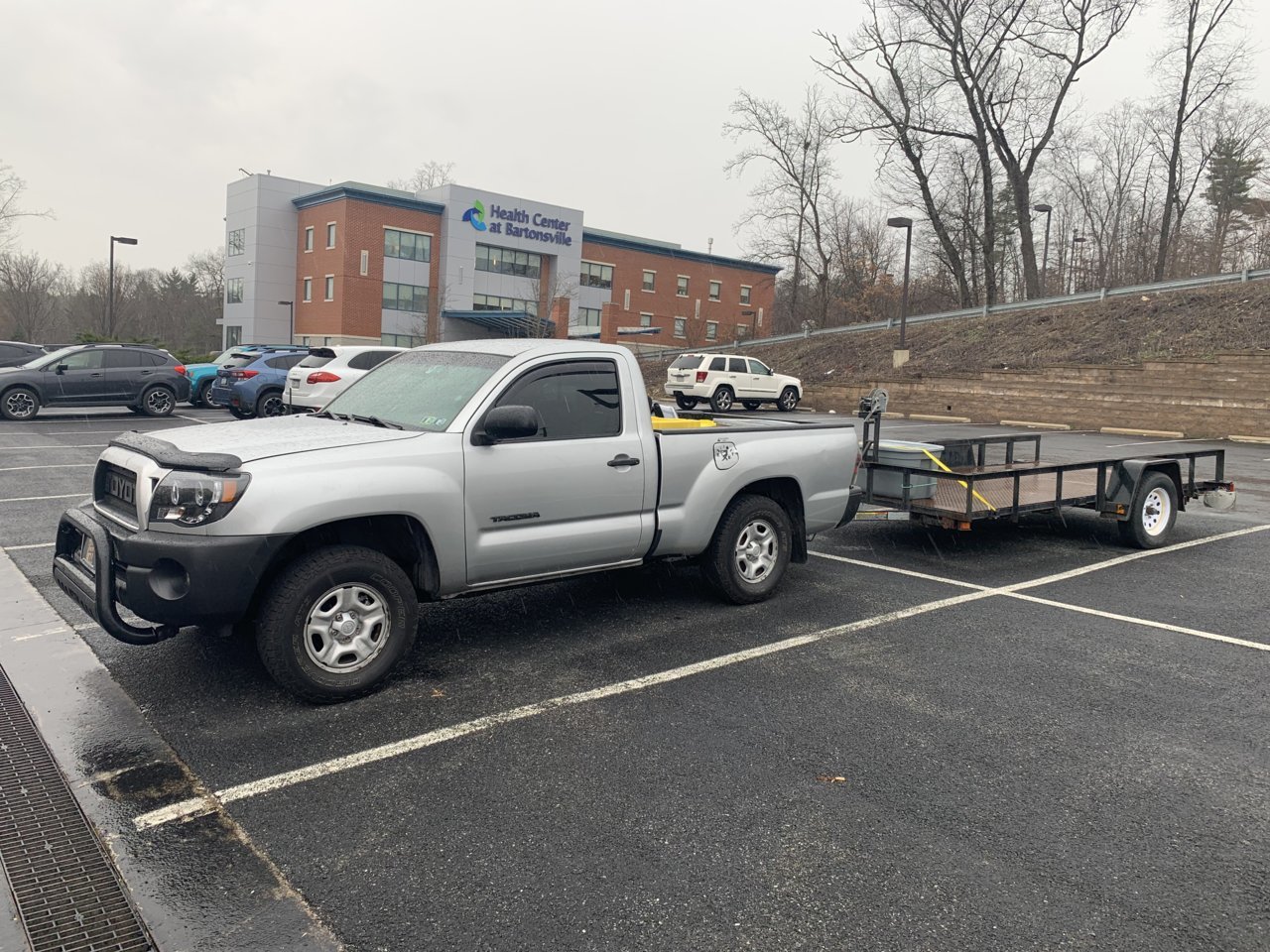

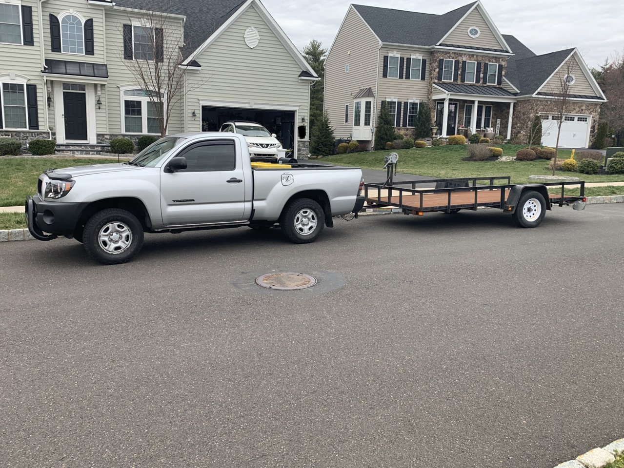

    I borrowed the trailer from my employer to help my girlfriend and her friend move out of New Jersey and back into Pennsylvania; I took this pic in front of my parents' house before the trip...
  19. Sep 27, 2023 at 9:54 PM
    #19
    PennSilverTaco
    PennSilverTaco Encyclopedia of useless information...
    Jul 15, 2014
    #134007
    72,418
    Charlie
    Central Bucks, Pennsylvania
    2010 Zombie Truck 2002 PT Cruiser

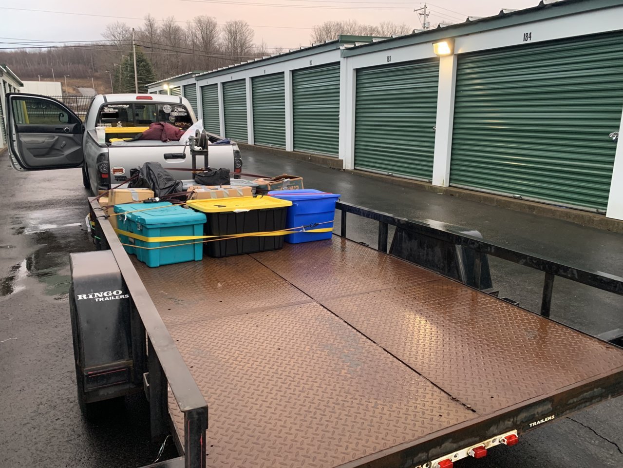

    First, I picked my girlfriend in Washington, New Jersey. After that, we had to make a quick stop in Stroudsburg, Pennsylvania as seen here...
  20. Sep 27, 2023 at 9:57 PM
    #20
    PennSilverTaco
    Jul 15, 2014
    #134007
    72,418
    Charlie
    Finally, we made it to the storage place in Mount Pocono; I ended up having more trailer space than I actually needed...
