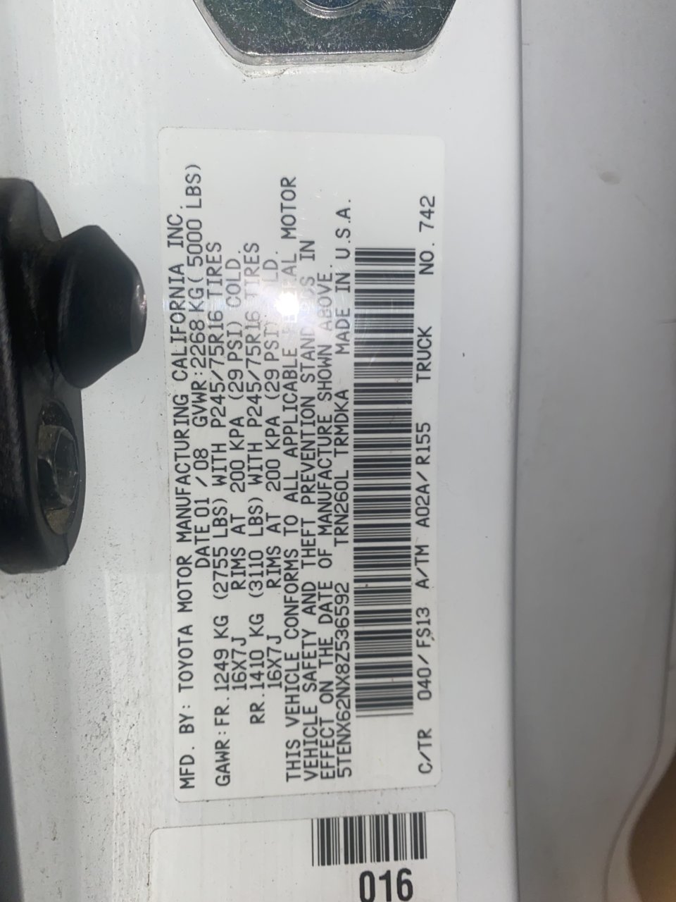

    4.10 - 6 lug 5MT 4x4 and 4x2 all have the same ratio.

    I thought that it was same whether it had two or three pedals? Also, I believe that 5-lugs like mine have 3.58 gears...?

    Thanks. I'm curious what ratio is in the truck he's looking at. My 5-lug 5sp has 3:30 and the tranny (R155) drops to 2.06:1 in second while others mfgs. Second gear gear is 2.3ish:1. This means I'm in second, floored going 45 mph trying to negotiate traffic. Reminds me of drag racing with a powerglide for those of you who know.

    Same axle code, different ratio 1G vs. 2G
    A02A
    I didn’t really need to look since I know the feel of a 4.10 from driving several 1G’s and my wife’s 3G T4r all with 4.10’s. AFAIK Toyota stopped putting 7.5 diffs in tacos in 2004 - all 2G+ have an 8 or bigger

    Mine’s A05A so 3.307:1 open diff. 2014. I should add that it’s a 5-lug on stock rims and tires (215 70R15) and tire size makes a difference which is part of the reason 6-lugs and 5-lug 4x4’s get lowered ratios.

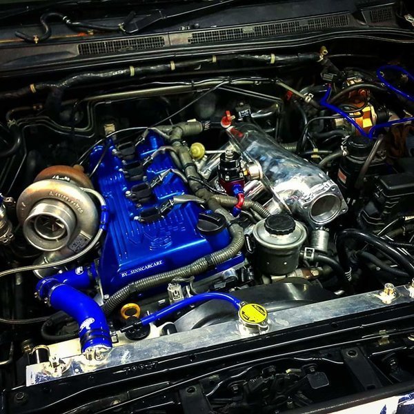

    Torspd Custom Turbo kit [] Borg Warner 9180EFR Turbo [] Haltech Elite 2500 [] TiAL Q BOV [] TiAL V44 Wastegate @ 15psi [] CP Pistons [] CP Carrillo Rods [] ARP Head studs [] ARP Main Studs [] ARP Header - Head Studs [] Ported Heads w/ 1mm oversized valves intake/exhaust [] Brian Crower Forged Stroker Crank [] Darton M.I.D. Sleeved Block [] Kelford Camshafts [] Torspd 160* T-stat mod [] APR Large Fuel Rail [] Walbro 460 LPH E85 Fuel Pump [] FueLab FPR [] APR T56 Conversion Kit [] KP RACING Built T56 [] McLeod Racing Custom Twin Disk Clutch [] One Piece Aluminum Driveshaft [] MGW Shifter [] Custom lowering kit [] Ohlins Front Coilovers [] QA1rear shocks [] Custom Ron Davis Radiator [] Dual SPAL Electric Fans []
    Pep it up...
