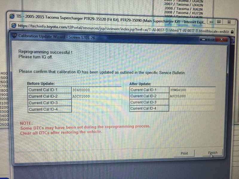

    After having issues with the Bully Dog flash, I bought a used ECU from eBay. The eBay ECU had 30480000 (pre-ping update) and I flashed it to 3YWG4100 (TRD SC) using the Mongoose Pro.
    The ping update for my truck is 30480100.
    So you can definitely go pre-ping to TRD, but it may not be possible to go post-ping to TRD.

    First, the Bully Dog / Magnuson tune was dangerously lean. I thought it was something to do with the install or a fuel delivery issue. So I spent a bunch of time and chasing a problem that wasn't there. It wasn't fuel related. It was the tune. It takes a long time for the ECU to go into open loop so there is 5lb of boost for a long period of time while the AFR is still 14.7. Eventually it goes into open loop and AFR falls but it's not gradual like it should be. More like falling off a cliff.
    Second, according to Bully Dog and Magnuson, you're supposed to be able to switch between the 3.00 pulley tune and the 2.85 pulley tune, which is a lie. Once you flash the Toyota ECU that's it no way to go back. No matter what you try to do with the Bully Dog, the calibration ID remains.
    Took truck to dealer to try to get TRD flash and they can't do it because Bully Dog uses the same calibration ID as Toyota uses. Toyota's calibration update wizard sees the calibration ID for the TRD flash even through it's actually the Bully Dog tune. So it will not even try to do the TRD flash.
    So the only way to get the TRD flash after having tried the Bully Dog tune is replace the ECU. In the end, I bought another ECU, a Mongoose Pro and a 2-day subscription to Techstream. Swapped in the ECU which had the stock N/A tune and did the TRD flash. Now the ECU goes into open loop much sooner and more gradually.
