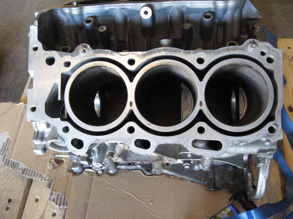

    Nitori
    Nitori Well-Known Member
    May 3, 2016
    #186058
    4,834
    Maricopa AZ
    2021 T4R SR5
    I think it's trivially easy to make a case that the 2.7 is far tougher than the 4.0...
    4.0 is a cast aluminum open deck block:
    2.7 is a cast iron closed deck:
    The 2.7 is ridiculously overbuilt. Not to say the 4.0 is weak by any stretch of the imagination, but materials wise that little 4 banger is built far in excess of its operating parameters.
    Kees, bijick, Misfit and 3 others like this.
