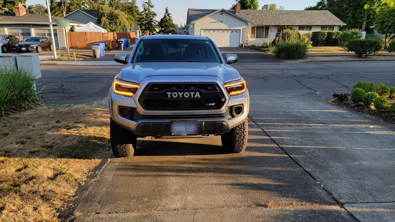

    Yeah I bought some silver sky metallic letters from tacos4cheap
