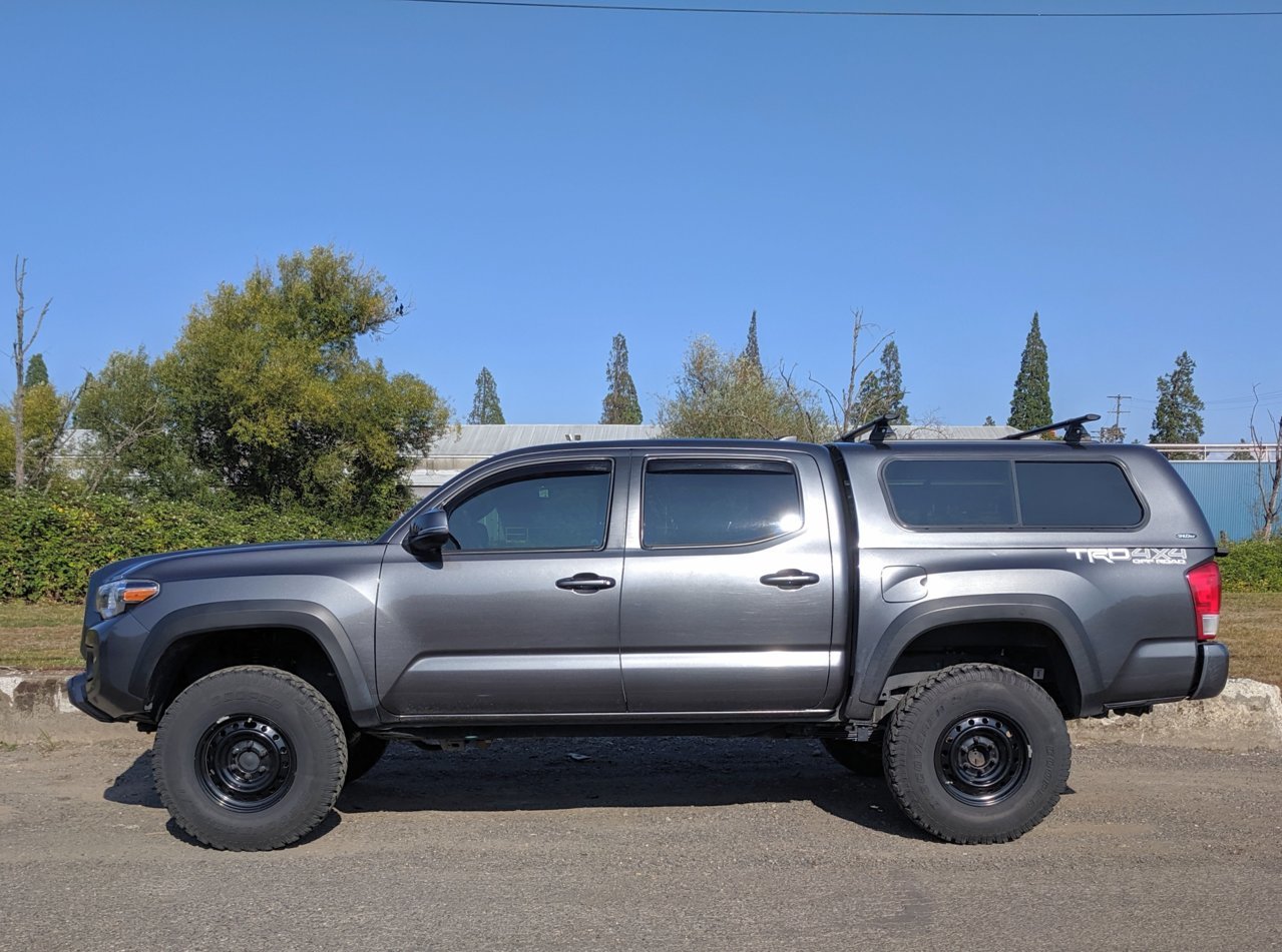

    I recently did the OME heavy duty lift and the only thing I have on the truck is a Snugtop. I should have measured it before and after but I'm pretty sure I have a full 3 inches of lift. I didn't do the bushing replacement and I don't have any noticeable vibrations.
