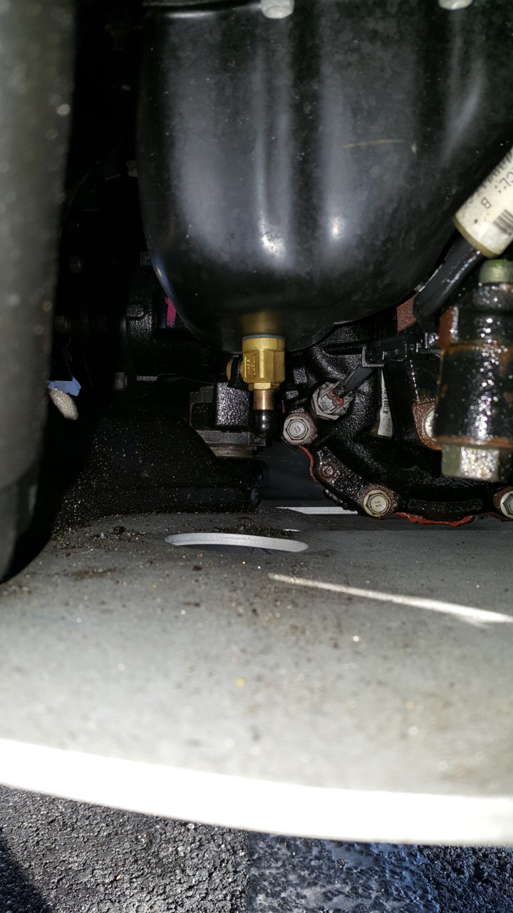

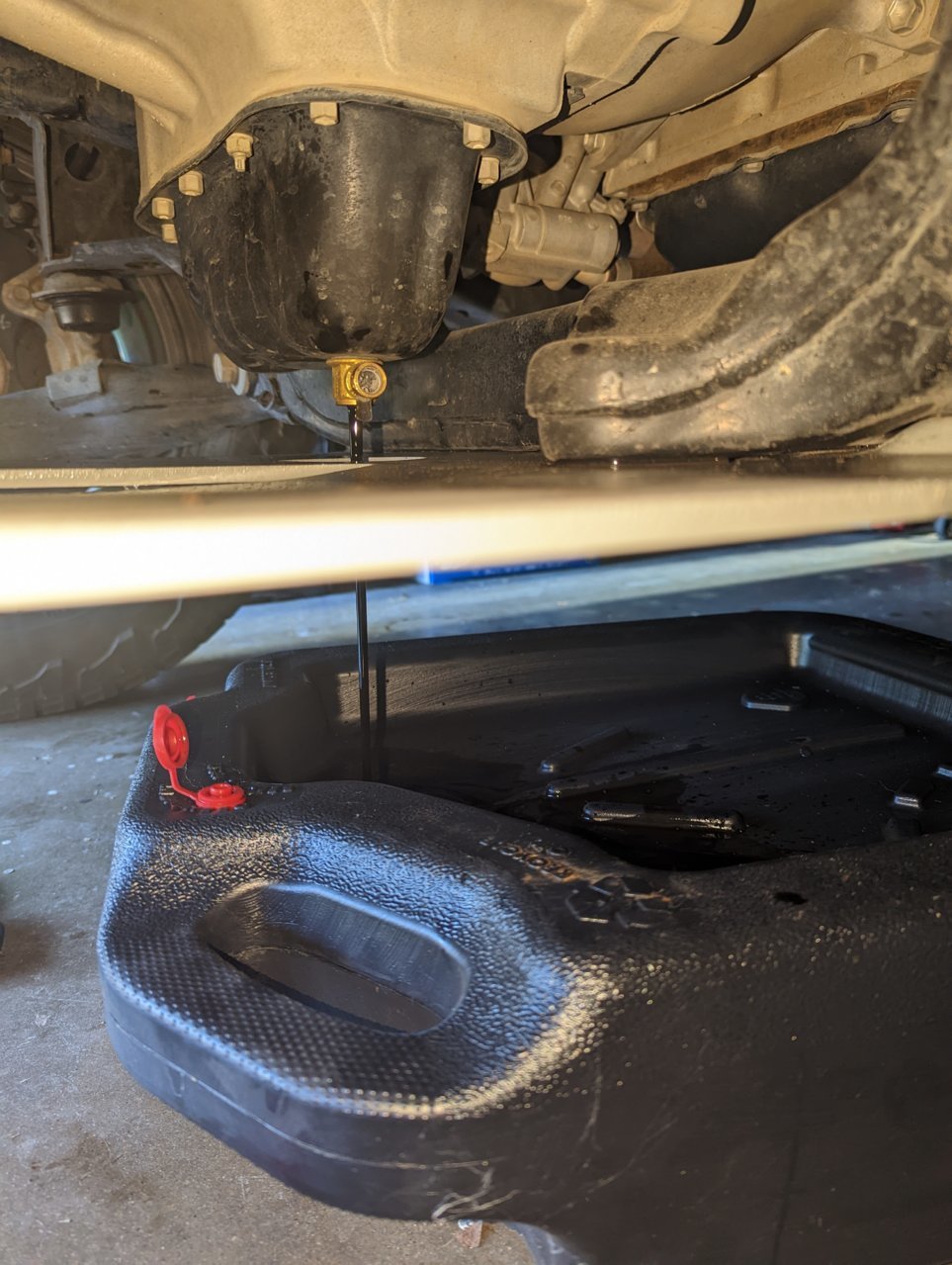

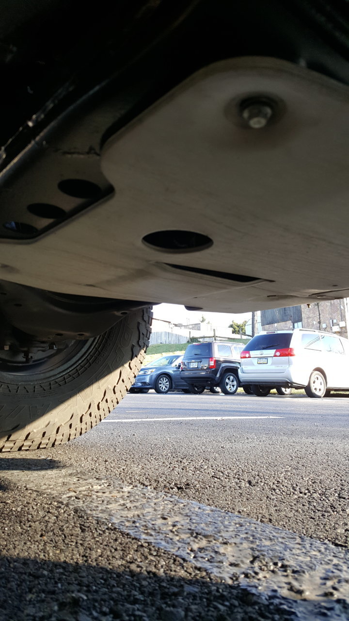

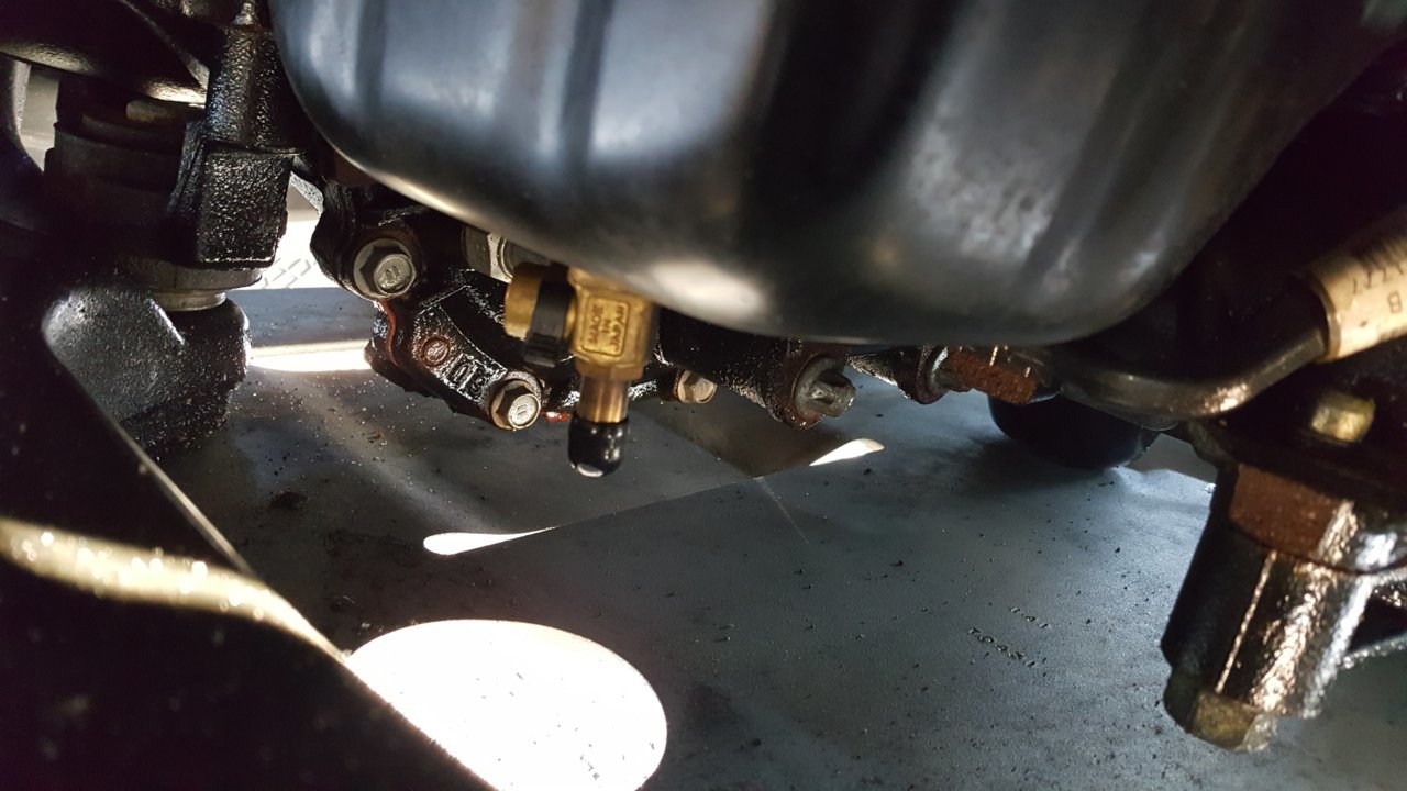

    Had a pro skid on my truck and it works fine with the fumoto valve, reach right up thru the hole or over the side of the skid to flip the valve. Ran one for 6 years on the truck! Let me find some pics and I'll post them for ya!

    I'm running the F133S with the TRD Pro skid plate. No issues at all. In fact, I think the F133N is the way to go for anybody considering this setup. I typically use mine with a plastic nipple in order to securely attach the drain hose. There's more than enough clearance for the long brass nipple supplied on the N.
