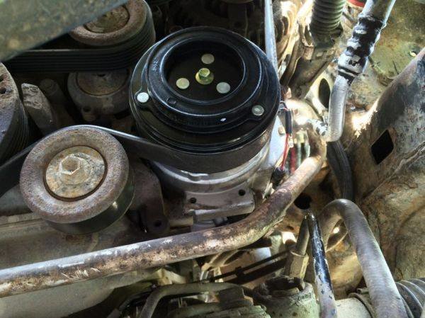

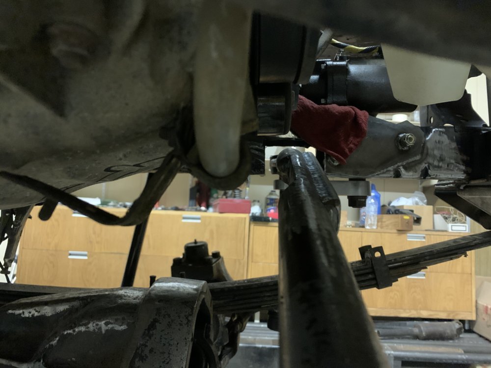

    So I did a SAS on my 09 and the tie rod is getting into my lower idler pulley.
    I don’t really see why it needs to be there. Looks like I could remove it and just get a shorter belt.
    thoughts?

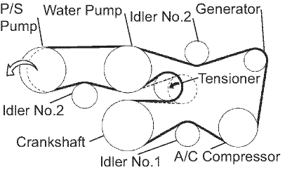

    Assuming that diagram is to scale (which it might not be) it doesnt look like you'll gain anything by removing the pulley. Wont it just hit the belt if the belt were to go straight from the crank to the AC?

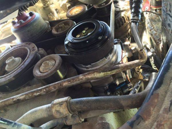

    I’ll take a picture. It hangs down an inch or so I would gain a little more space.

    Here’s a picture from the interweb

    Ahh yup I see what you're after. Wont be much contact with the AC after removing that idler, but thats not the end of the world I suppose if you're fine with maybe loosing AC and defrost haha

    How much is it hitting by? I’m assuming this is under full compression of the suspension so couldnt you just extend the bump stops a smidge?

    I’ve looked at your pics. The tie rod is no where near the motor. The drag link appears like it might be close though. Can you get a dropped pitman arm for whatever steering gear you are using?

    So I had made a drag link and it was hitting so I notched it out.
    I want to make a new one that’s not notched.
    I ended up bending the current one cause it hit the passenger frame so I have to make a new one and notch the frame anyways.
