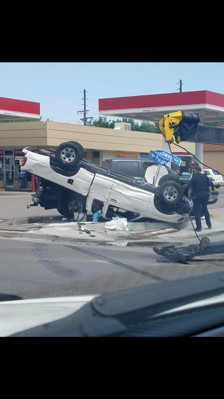

    This truck I passed by last week, probably has a good motor in it and will be at some salvage yard soon.
    You need to find a good engine from a salvage yard with the engine in the truck
    so you can get an idea of how it was cared for and u can run a carfax too
