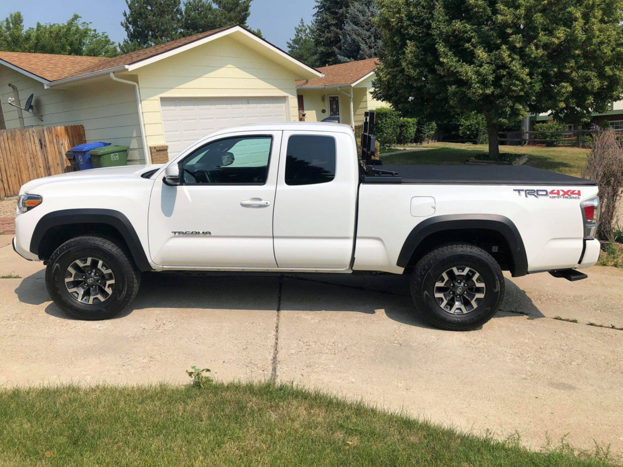

    I just purchased a stock 2020 TRD Off Road Tacoma and want to take it out on the trails. (Imagine that!)
    I had a base model 2013 Tacoma that I purchased an after market skid plate for and took some pretty heavy hits on it. Will OEM skid plate hold up, and does it offer sufficient protection?
    I'm far too old to want to crawl around in the dirt to try to fix things. LOL
    BTW, I plan to put sliders on my new truck as one of the very first mods!
    Thanks!

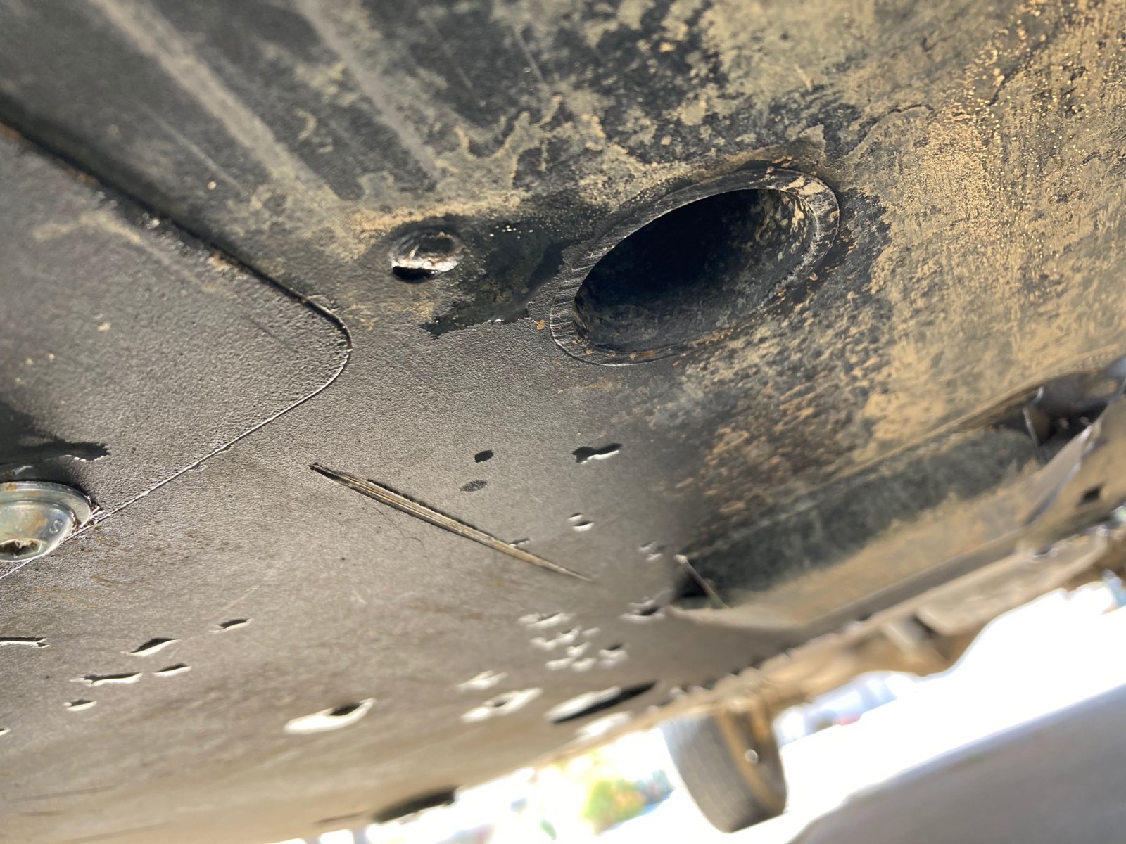

    6,156
    Drobe on a "road" (historically a stagecoach route) that had a 100 ft all-rocks stretch and caused this. My steel (not aluminum) RCI engine skid took this and did not bend, engine stayed safe.

    King's, Camburg UCA, Dirt King LCA, armor
    ‘High Density Molecular Weight, probably poly-propylene or poly-ethylene
