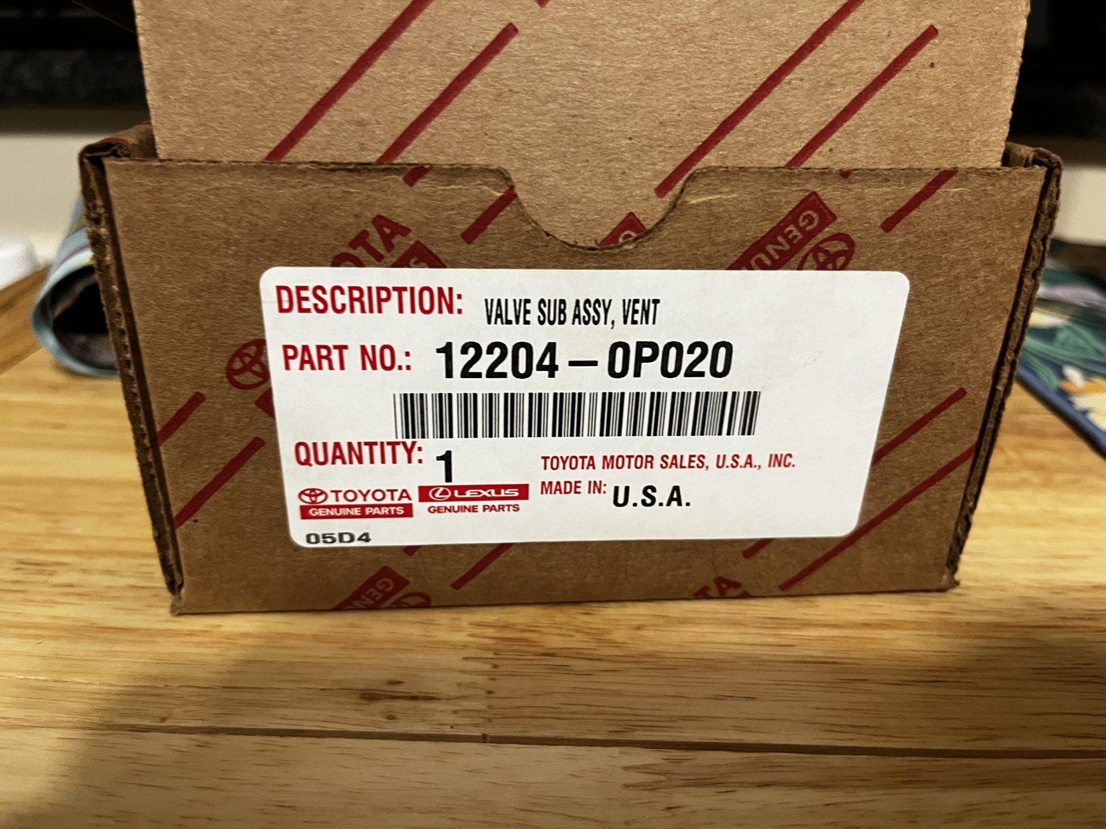

    Do you have the part # for it ? Mines due or almost due. :thumbsup:

    Gfenza89
    Gfenza89 [OP] Well-Known Member
    Oct 1, 2018

    t0p_d0g and Stevie17[QUOTED] like this.

    24 Celestial Silver Sr 5 DCSB 4x4
    Thank you sir much appreciated :fistbump:
