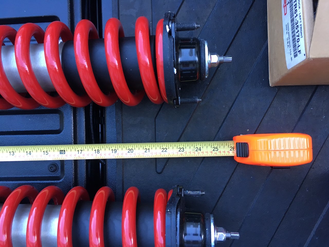

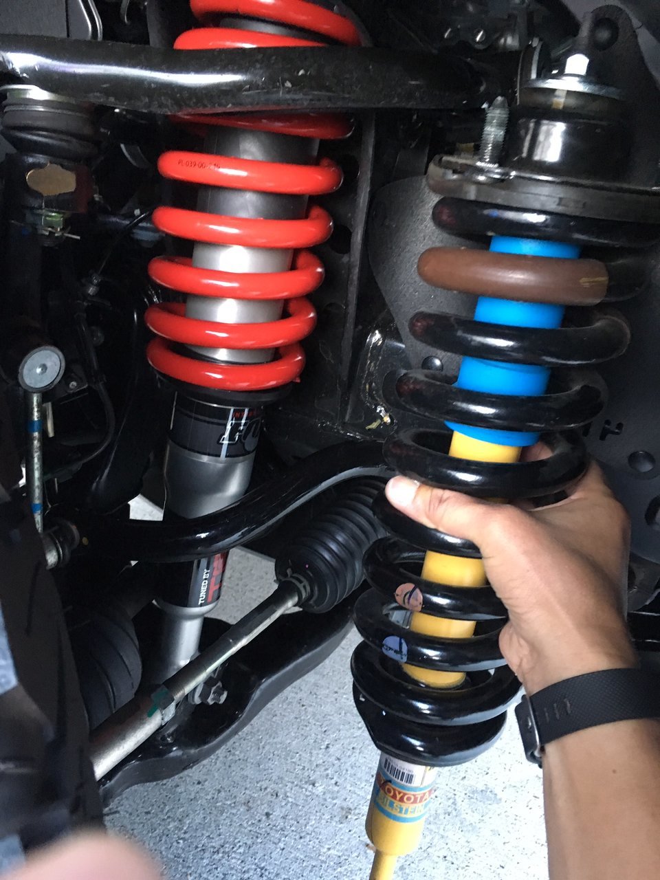

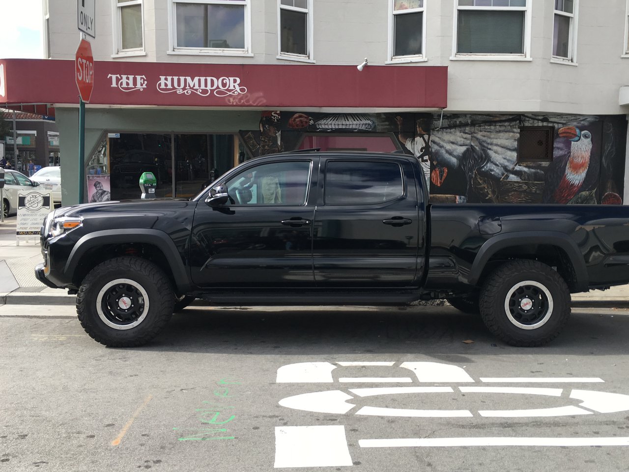

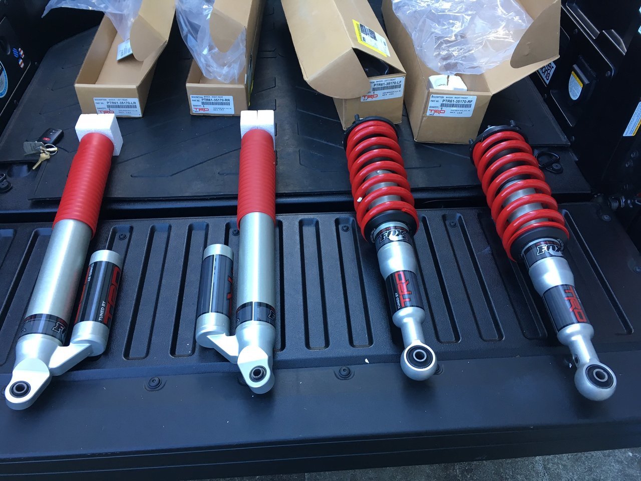

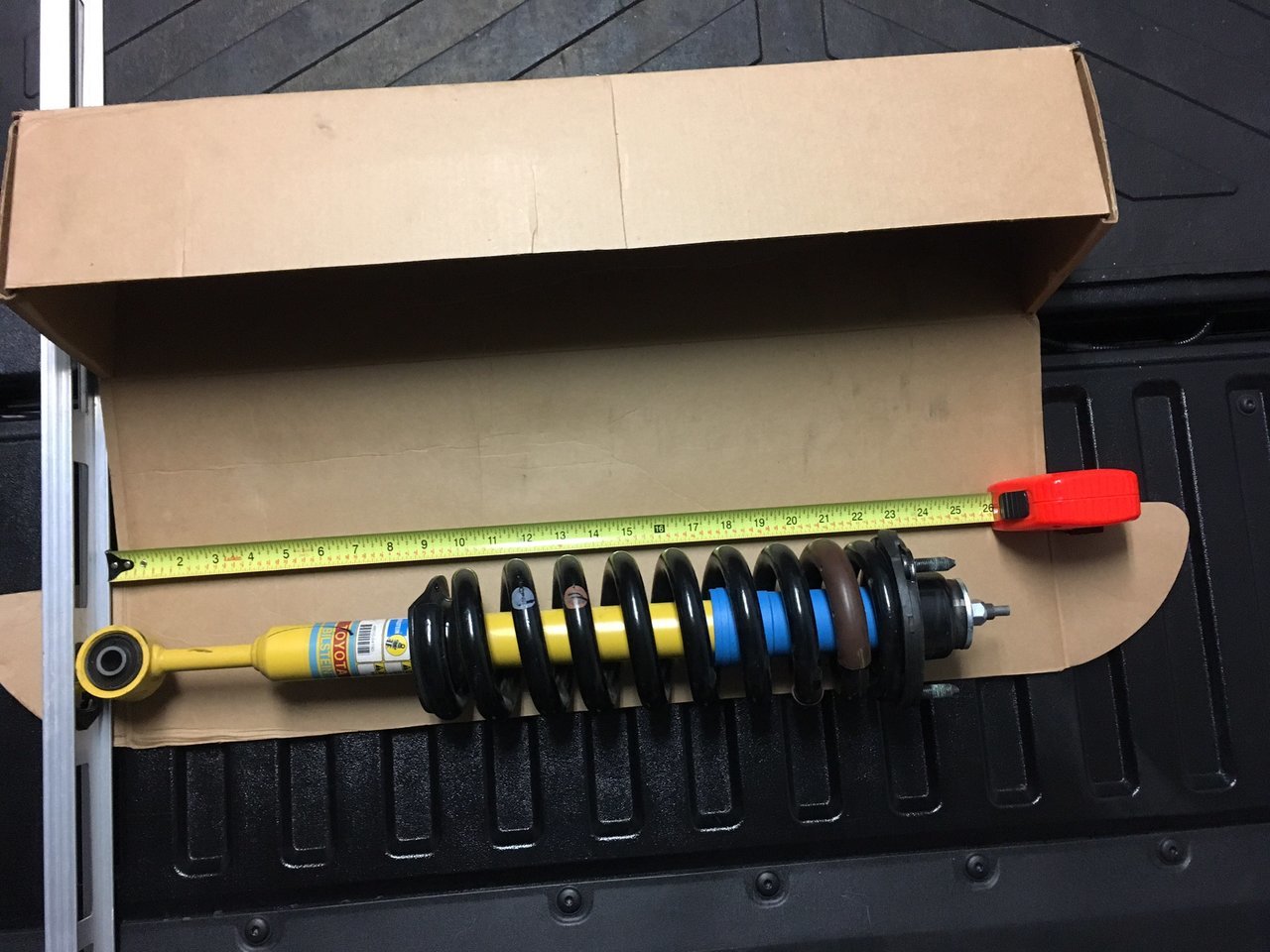

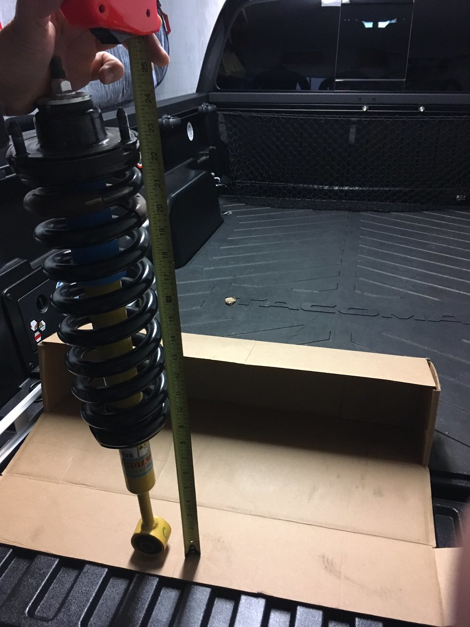

    97DBAC10-56D4-43E3-9AAB-184F84FE3873.jpg A1805988-841C-4CC6-BE01-6032B022847F.jpg 36250298-BCB7-46B7-B5F9-FDCDECAF8D32.jpg E75E5A4F-23BA-4C0C-BB39-A17037024D06.jpg 70A7694D-8615-42DC-B80A-C3DC2E42194B.jpg 6DC615F1-FE1B-4FC1-9422-54EB31ED3DC6.jpg
    I installed the Pro Fox shocks on my 17 OR and measured the front before and after installation. From the ground straight up through the center of the wheel and up to the bottom of the wheel well, the Pro Fox shocked raised my truck exactly one inch. I performed the same measurement in the rear and it remained the same. Just FYI, I have the DC w the 6 foot long bed. I’ve not actually measured a factory Pro vs. a factory OR on the dealer’s lot for height difference but based on my personal experience I can say w 100% certainty that the Pro Fox shocks raised my rig exactly one inch in the front. You can tell from the profile pic that my truck is still not quite level but it has less of a rake than a stock OR DCLB. I also have 265/75/16 KO2s.

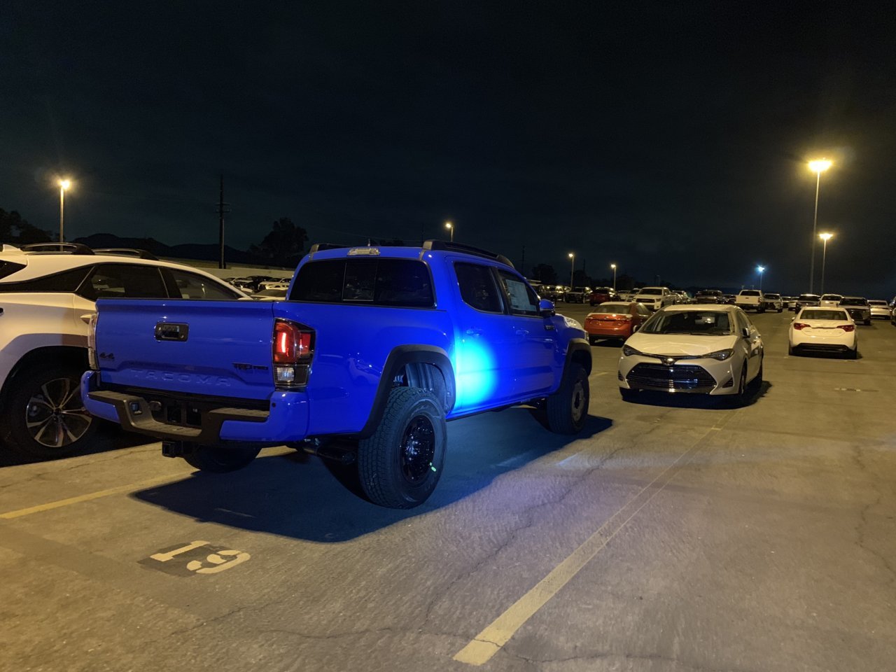

    Here is a picture of a 2019 I took at work. It looked taller next to a OR taco by a half inch. The price tag was stupid higher too
