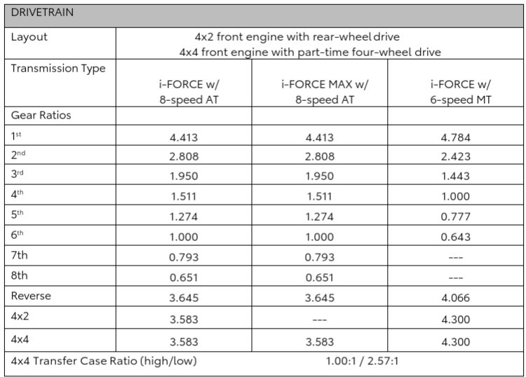

    @yotadust, not sure which gen you currently have. If it's a 3g, consider the following.
    3g: 3.6 (1st gear) x 3.91 (your final gear ratio) x 265lb-ft = 3,730lb-ft torque (at 4,500rpm!)
    vs
    4g: 4.413 x 3.58 X 317lb-ft = 5,012lb-ft (at 1,700rpm)

    Have they ever put 4:11 gears in a Tacoma or any of their U.S. market trucks? Even as an option? That's what they need. (Maybe not/prob not, since I would think it would still be screaming at highway speeds even with the '35 inch tires.)

    4g Tacomas with a manual have a 4:30 rear and a lower 1st gear (stump puller!). Sixth is a little taller but it will still run higher rpm than the auto in 8th. The manual will be turning almost the same rpm as the auto in 7th.

    4g manual gear ratios trump all other gens (by a significant margin) and of course, has more torque to multiply.
