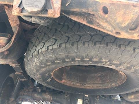

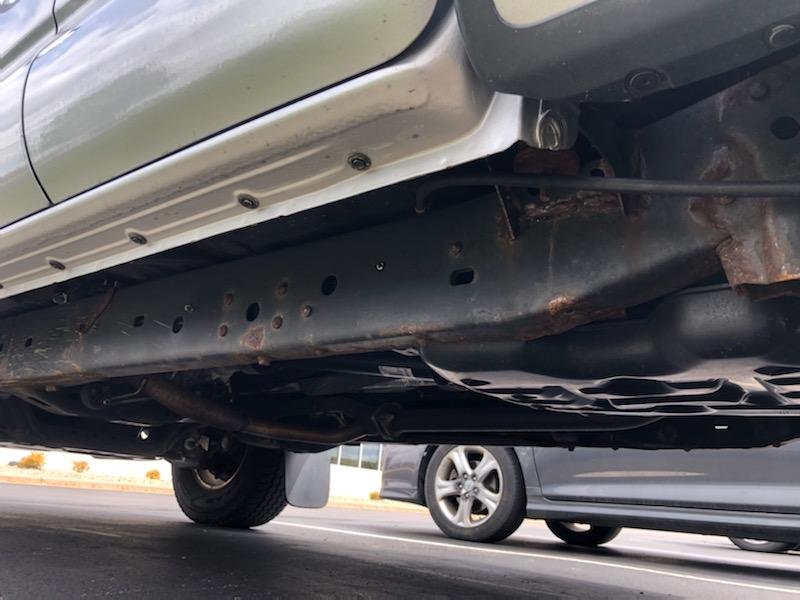

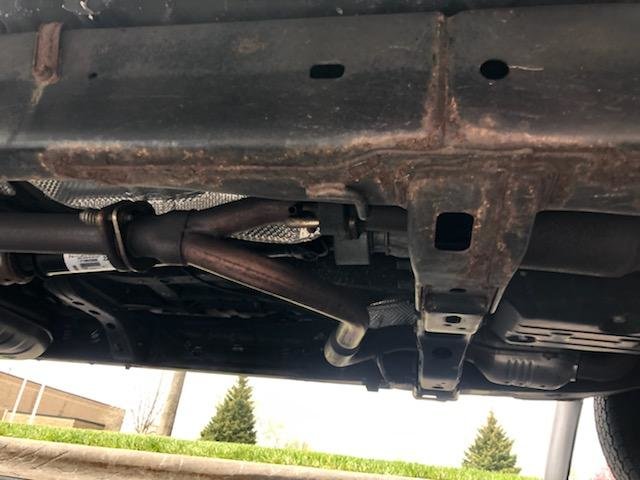

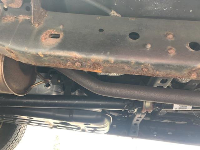

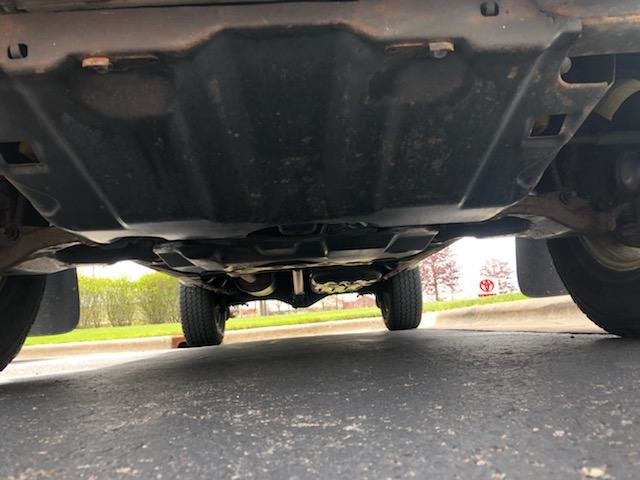

    I am currently looking at buying a 09 access cab Tacoma from Wisconsin. The seller sent me these pictures of the undercarriage and I wanted to see what y'all thought of the rust.

    Hard pass for me.

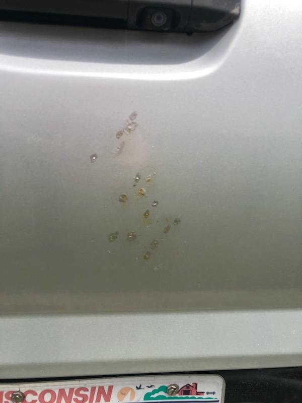

    the amount of rust, the rust on the spare tire and the rust on the tailgate. I personally would pass. Others would probably buy.

    For a 2009 Wisconsin truck, I say that's clean! My 2008 Canyon was far worse than that and still wasn't even close to unsafe.

    Fairly good shape for 12-year old truck in the north. The hitch tends to rust before the rest of the frame. (My '10 had rust on the hitch driving off the dealer's lot.) There's nowhere nearly enough rust to warrant a frame replacement.
    I would be more wary of all the leaks and mechanical issues with a 12-year old 2nd gen. But you'd need to inspect the truck in person.

    The place to look and touch are the boxed sections around the cats. Those areas rot from the inside.
    In fact, under the current frame treatment, those boxed sections are really the only parts they focus on.

    Also that looks like the factory spare tire, which means it's gone on 2x its intended life and is probably hard as plastic by now. Budget a replacement.
