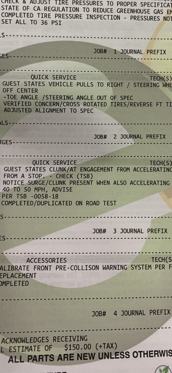

    I had my TSB 58-18 done by my dealer yesterday and the truck accelarates like a different truck now. I realize that the computer will relearn how I drive for the next few thousand miles. I’ve got 3200 miles on my 18 Tacoma DCSB TRD OR. I love how responsive it is now. I was told (Facebook Tacomaworld thread) that this is temporary and that it will revert back to sluggish taco in about 2k miles. Is this true? Or is this person just trying to get me to buy OVtune? Just curious, any experiences to prove or disprove this would be appreciated. Thanks.
