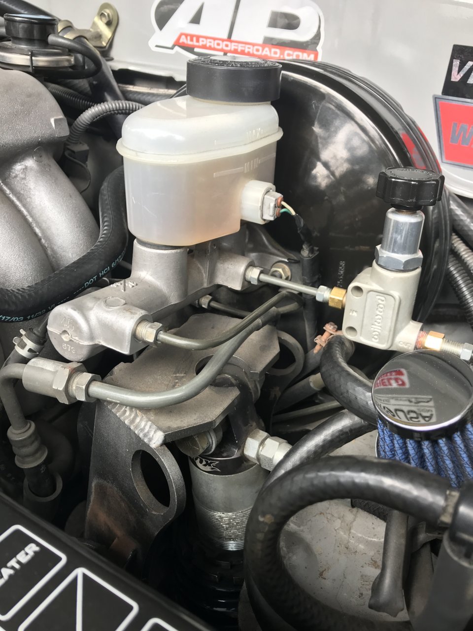

    OP,
    If you have ABS, ditch that garbage and rear LSPV.
    Add a Wilwood unit to dial in when the rear brakes come in.
    Once set, it’s a beautiful thing.

    What is this Wilwood unit that you speak of? Do you have a link?

    So now you have to manually adjust it based on weight in the bed vs the original that does it automatically. More of a down grade for convenience sake.

    Negative...
    Set it once and forget it.
    EDIT: What convenience are you talking about?

    Does it self adjust?

    No, took about an hour of testing/ adjusting but once set, it's all good.
    I must point out that I added this after I removed all of my ABS system, including the bulb in the dash.
    Stops on a dime.

    It's only set for what ever weight you were carrying at the time you set it. If the rear load changes then it's out of bias. Hopefully you won't have to panic stop at that time cause you could end up sliding further than you want.

    OP,
    If this is really a concern after many posts on the topic, figure it out. This works, period. It greatly improves braking without concern.
    My truck has gained 1,200 pounds since birth in ‘03 and has zero issues.
    You will not regret this upgrade.
