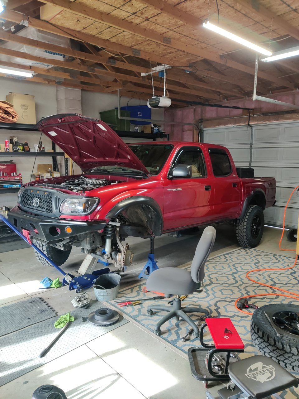

    I just went at it...its a direct swap over so it basically just like replacing what you got. Def worth it for performance and looks.

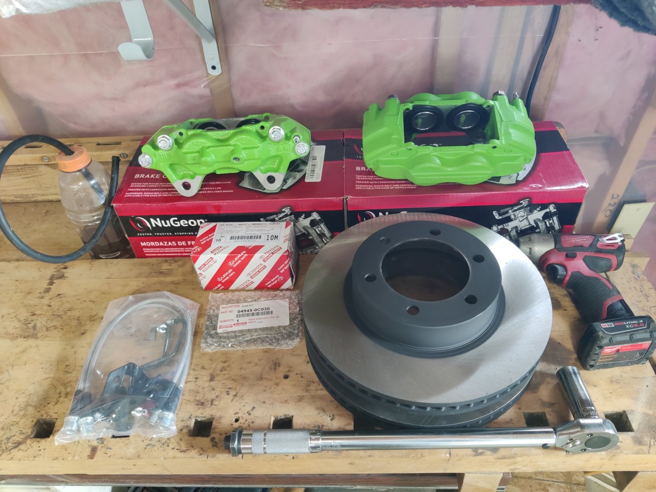

    Recently did the Tundra brake swap with the larger 13WL Calipers and I'm very pleased with the outcome.
    I still had plenty of meat left on my original brake pads so it's not like I'm comparing old worn out brakes to exaggerate the difference of the new parts either.
    Definitely worth doing.
