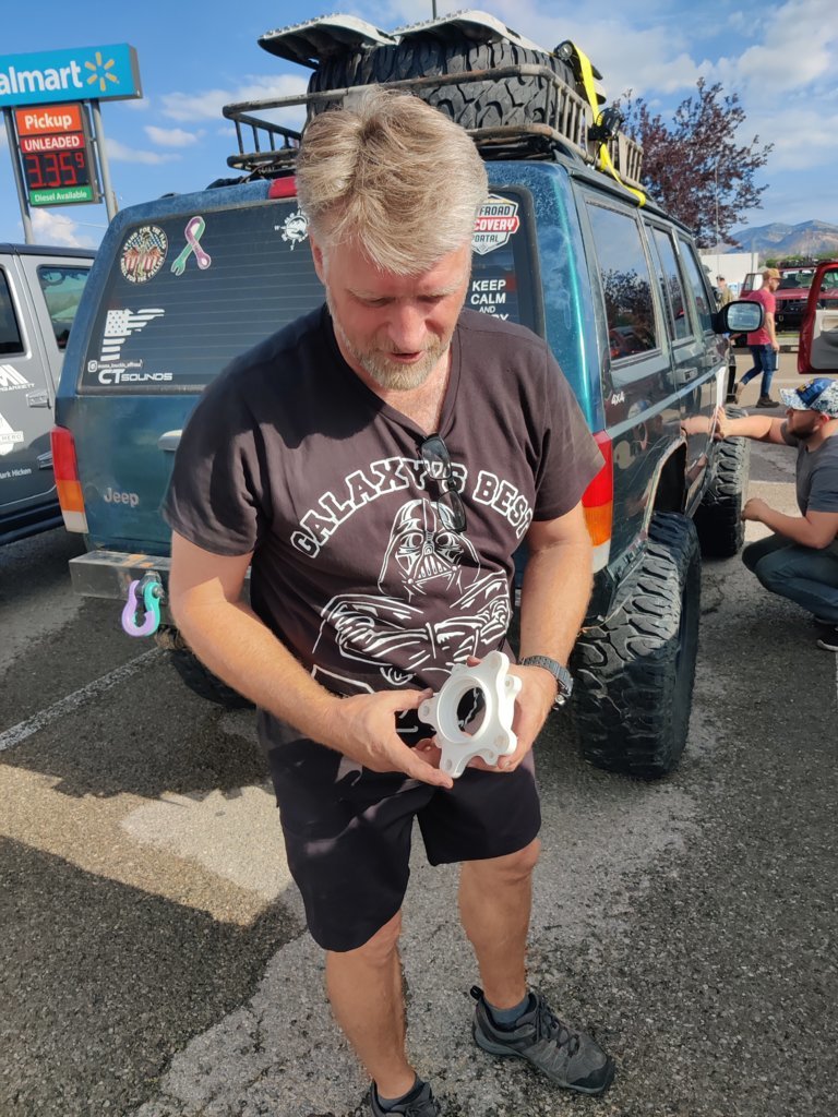

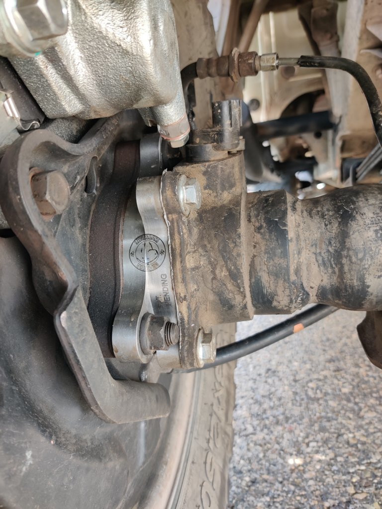

    On the subject of GX460 brakes I've got a buddy who's recently patented an adapter that makes the rear disk brakes from the GX460 a bolt on option for our trucks. His first test run on the setup was a 4 day overland trip we did from Price Utah through Moab and into Colorado.
    I thought this might be a good spot for the info. The adapter is produced by Capivara Industries and can be used with wheels as small as the stock 15" wheels found on the early Tacomas like the 96 he was testing it on.
    That's Bill the brains behind the design holding a 3D printed model.
    It sure is a tight fit with his little 15" wheels but they performed flawlessly on our trip, even the original emergency brake cable is reused unmodified in the design.
    If I remember correctly the bracket/adapter was 1¼" wide so it does add a bit of width to the overall length of the back axle. Some may see that as a benefit and some may not. I'm already using spacers ¾" spacers in the back so I could ditch the spacers and still end up a wider than it is now.
    I'm interested to see how things turn out for Bill and his adapters and may end up being one of the Guinea pigs or more appropriately named Capivaras (its the Argentinian spelling of the word for those of you familiar with Capybara)

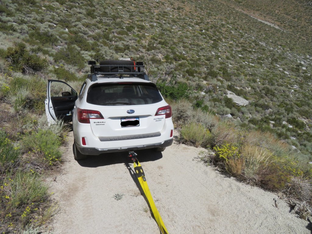

    Here is a recent testimonial for the worthiness of the Tundra rotor/caliper upgrade.
    My cousin and I like to take his Subaru Outback to places it really shouldn't. Our latest adventure was to our favorite campsite. It is in the eastern sierras near Lone Pine. Once off the freeway the trail starts at 4000' elevation and 6 miles later ends at 8500'. During the climb to the campsite, we had to stop 6 times to let the Outback transmission cool down. We had big concerns about the Outback brakes going back down.
    Well, we didn't make it a half a mile till the Outback brakes started smoking. We ended up tethering the Outback to the Tacoma and left the Outback in neutral. I had to drag the Tundra brakes for almost 6 miles. There was no brake smell or fade. Most of the time the Tundra upgrade is a nicety but this time I think it was a necessity.
