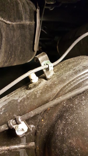

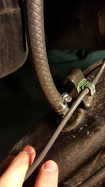

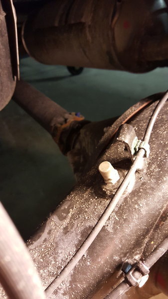

    Your welcome man, anytime! Just change it every 30k and you'll be good. Also do a rear differential breather mod if you haven't done one already. It will prevent water from getting into the fluid in your differential. Cost about $20 and well worth it!

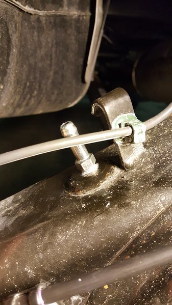

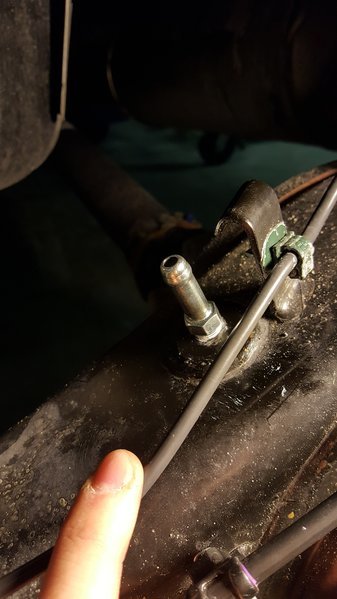

  8. Jan 18, 2017 at 7:21 AM
    moe2o4
    moe2o4 Well-Known Member
    Feb 9, 2015
    #148236
    7,849
    Corey
    Pittsburgh PA
    2016 SR Silver 2.7L 5 Speed
    OME 3" Lift, 32" Tires, Lots of Mods!
    My Truck!
    [​IMG] [​IMG] [​IMG] [​IMG]
    [​IMG] [​IMG]
    MarcM, G8R_Taco, Rparker017 and 3 others like this.

    What thread is that fitting in the rear diff? @moe2o4
    moe2o4 likes this.
  20. Jan 18, 2017 at 8:16 AM
    #20
    moe2o4
    Feb 9, 2015
    #148236
    7,849
    Corey
    Pittsburgh PA
    Caltech90[QUOTED] likes this.
