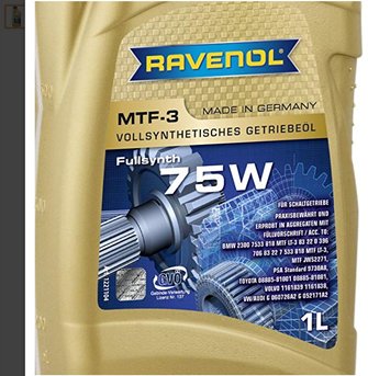

    This does, and it’s what I use. Look closely at the label.
    Ravenol J1C1003 SAE 75W Manual Transmission Fluid - MTF-3 Full Synthetic (1 Liter) https://www.amazon.com/dp/B00QPCL7ZE/ref=cm_sw_r_cp_api_i_Z3yCDbRPX1X68

    I'm about to do my t-case with the Ravenol 75w MTF-3 variant (and Red Line 75w90 for F&R diff) and it lists it meets TOYOTA 08885-81001, TOYOTA 08885-81081 upload_2019-10-17_8-13-3.jpg
