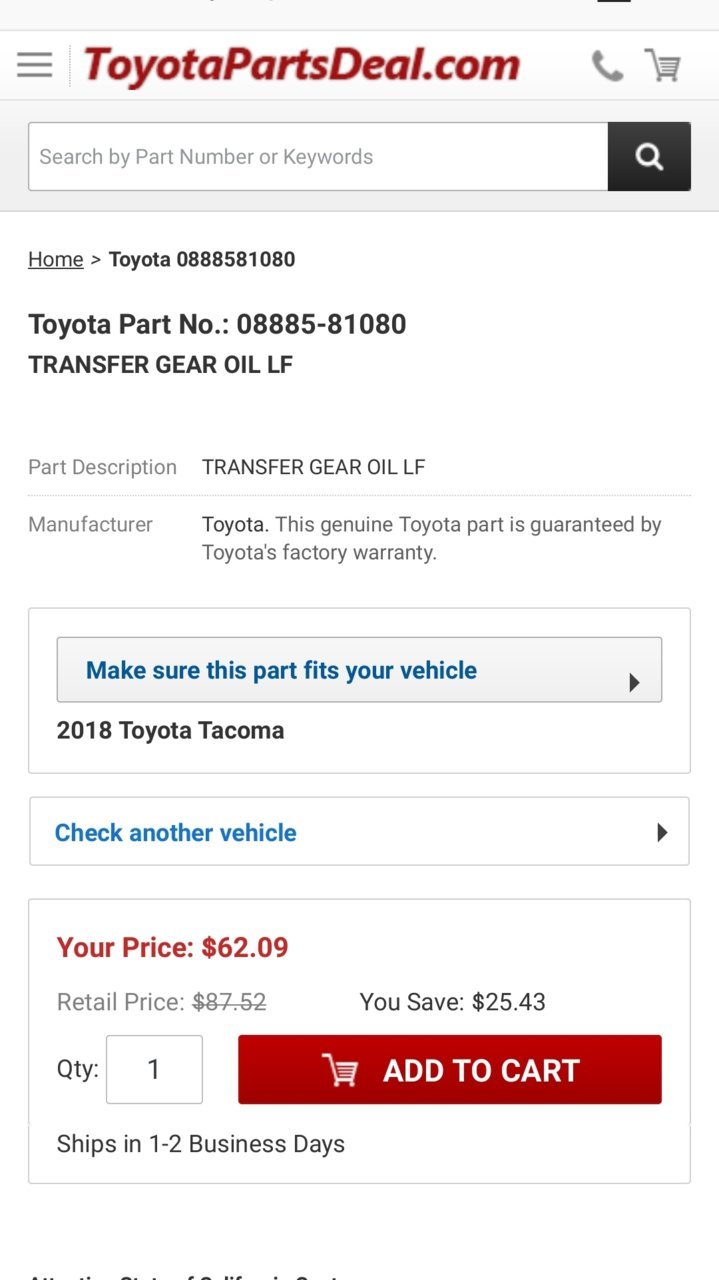

    MtnFisher
    MtnFisher Well-Known Member
    Feb 17, 2019
    #283385
    1,088
    ZeroDrift
    Location: Behind enemy lines for now
    2019 Tacoma TRD ACLB V6 MT
    Currently running Goodyear DuraTracs with "ghetto" wheels
    https://www.toyotapartsdeal.com/oem/toyota~transfer~gear~oil~lf~08885-81080.html
    BOZOJUICE likes this.

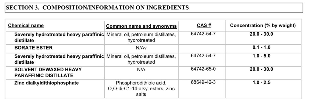

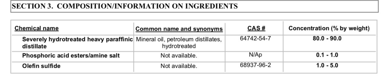

    One of the places you can sometimes gather at least a bit of information about these fluids is the SDS. It didn’t list much of interest for the LF fluid:
    However for the LV fluid, it lists it as Mobil HYDRAUL 56 with the following:
    So I guess take from that what you’d like.
    Jeff
