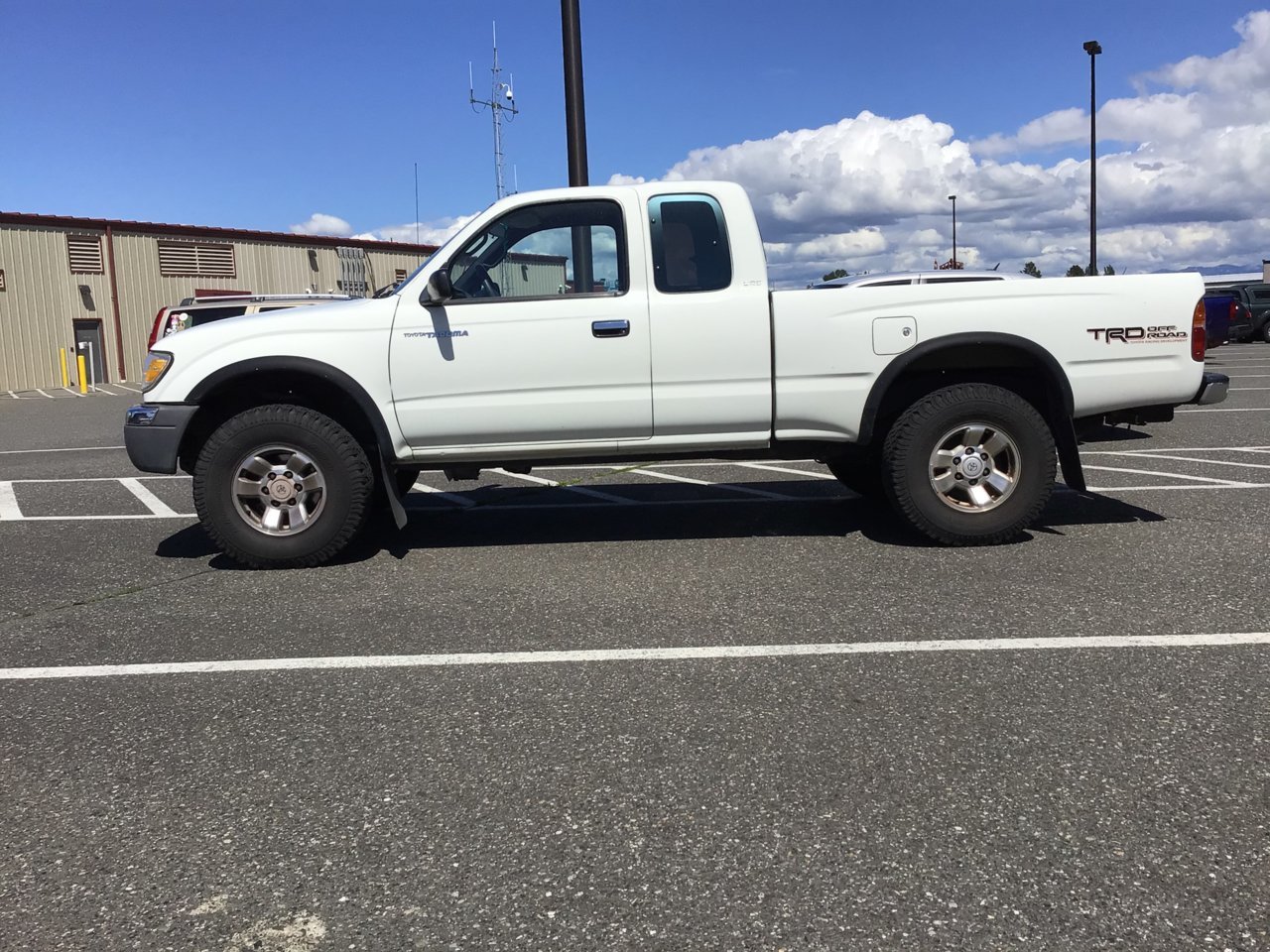

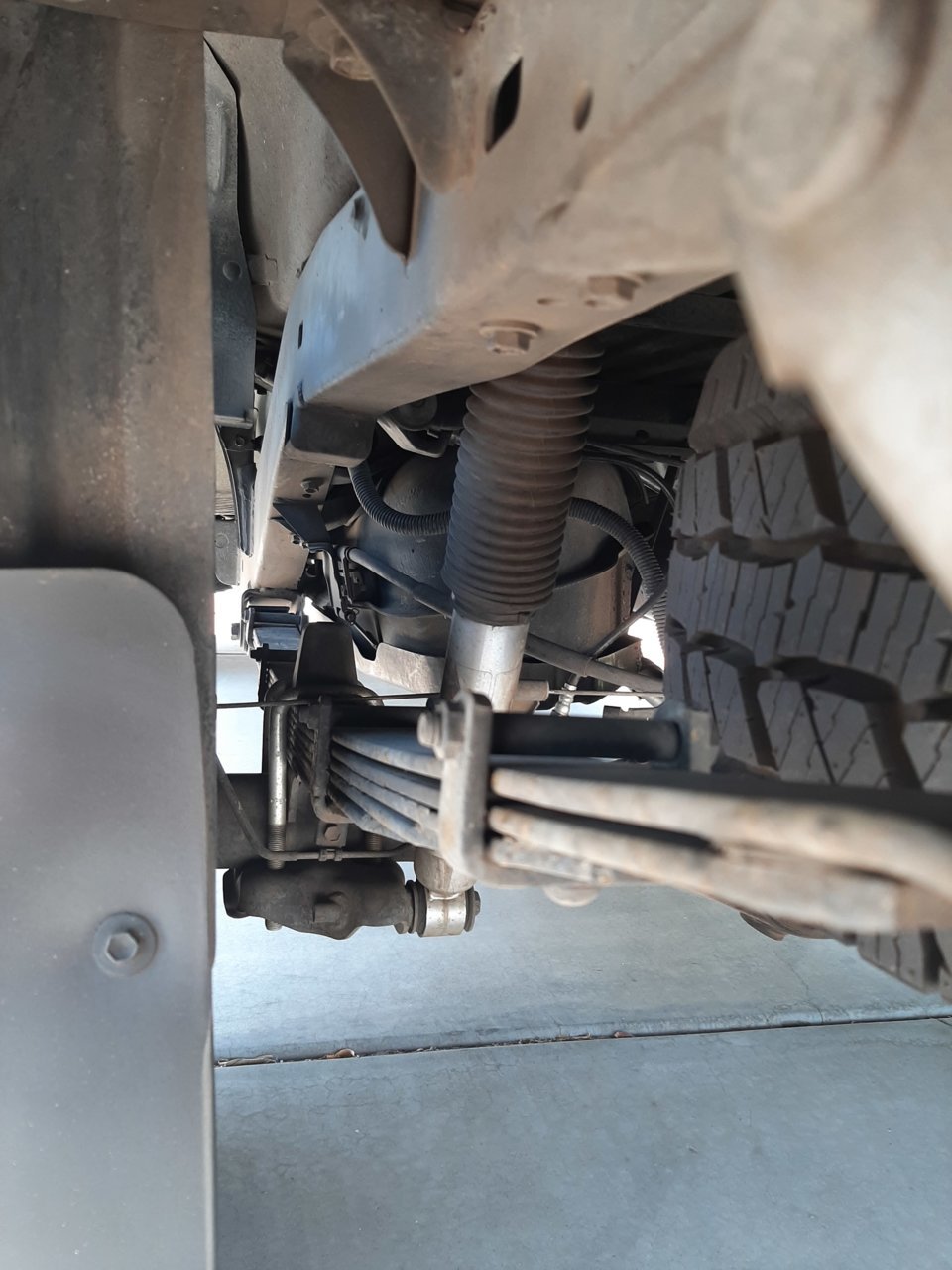

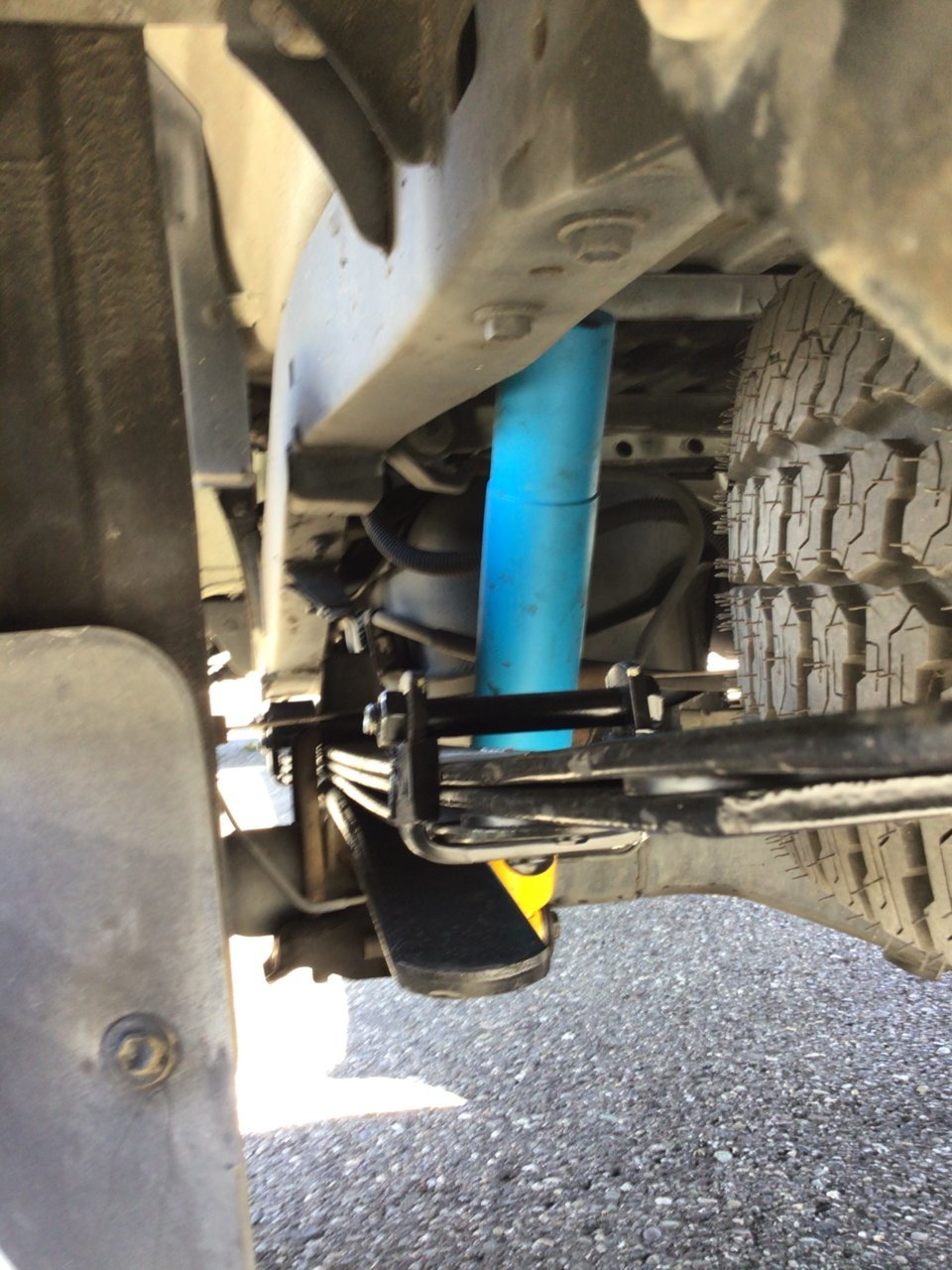

    So, just an update, I did install 4600s and a pair of standard/OEM General Springs leaf springs. I didn’t feel the need to replace the front springs.
    The back end has been raised noticeably, and the truck now has a slight rake, even though this can’t really be discerned in the attached pictures. The old leaf springs were definitely shot and sagging. Ride quality has definitely improved, and the truck’s ride height has been restored.
    I was warned to not expect the springs to have a lot of positive arch after installed and as the second picture shows, that’s the case. There’s still a slight “W” even though the back end has been raised in comparison to the old springs.
    If the General Springs leaf springs start to sag prematurely, I’ll post an update.
    Thanks for the suggestions.

    That's interesting because my rear leafs are kind of like a W as well but the truck drives fine. It is the stock OEM leafs and they are about 18 years old now. I was going to replace them because I heard that they are shot if they are in the shape of a W. Now that you said your new springs are kind of like a W....I'm wondering if it's normal and that I should leave my leafs alone.

    My new SD springs have exactly the same W. I think it’s the true normal for these trucks

    If you go to the first page in this thread, I posted pictures of what my original leaf springs looked like. You can see that they’re a bit worse than the new ones. Even though the new springs have a bit of a W shape to them as well, they lifted the back end of my truck considerably. I immediately noticed more space between my tires and the fenders. The garage that did the work told me that the old leaf springs appeared much flatter than the new ones once they were out of the truck.
    It would be difficult for me to say how much the new springs contributed to the improved ride quality, since I had the shock absorbers replaced at the same time.
