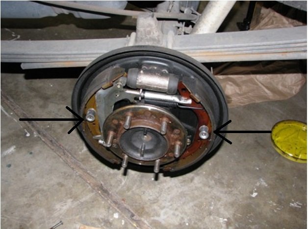

    Hi, I have a 2.7 2009 tacoma. I have a hard time taking the drum off using the two 8m X 1.5 bolt. I released the hand brake, spray wd40, turn the two bolts and the drum does not come off. I heard 2 snap and noticed 2 pins fell out. Put everything back (except the pins) and call it a night.
    What am I doing wrong, help?
    I have done a drum brake on a 1995 honda accord and had no issue remving the drum on the accord.
    Obviously this is not my picture. But I think the two pins (see arrow) snapped off.:(

    I only jacked the car up one side (rear driver side) because I just wanted to check the shoe for wear. The other side is not off the ground so I wonder if that cause the e-brake to not release fully. I will try jacking both side and try again tomorrow and I really need to re-install those pins before I can drive the truck again.:mad:
    Should have left it alone but the rear were making noise and my truck has 82k miles.

    I second this. My mistake was not backing off the shoes with the star nut. Once I did that everything went smoothly. And online info like this helped a lot for someone who rarely touch drums brake. And be patience helped. Thanks all.
