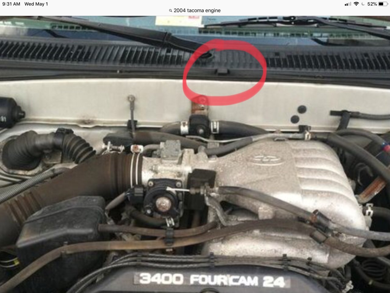

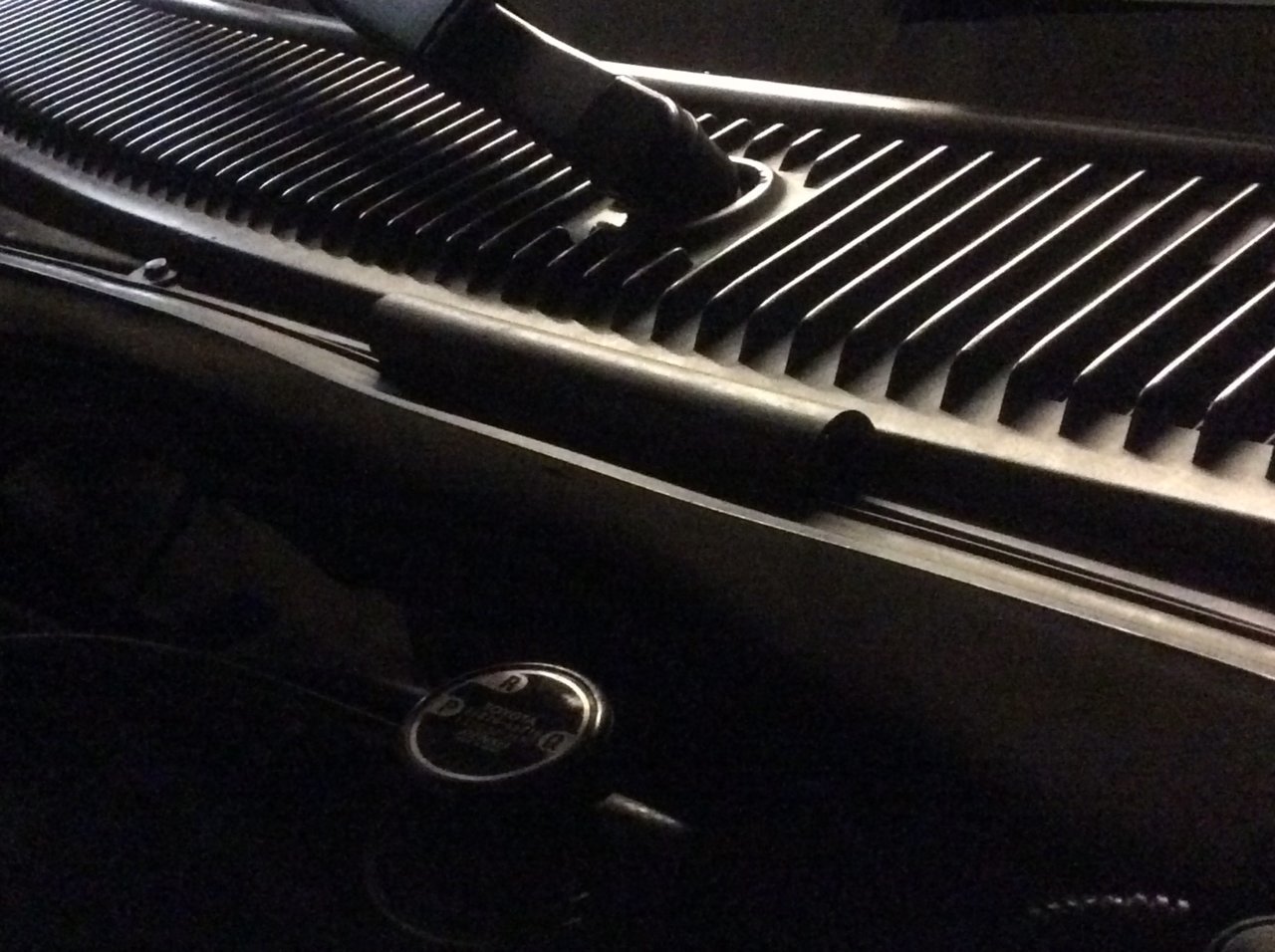

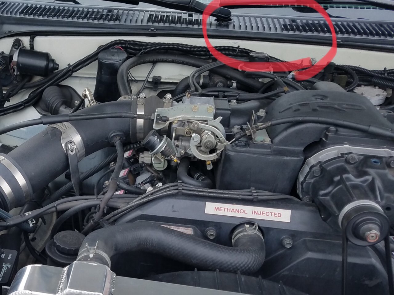

    So here is something I found out.
    The Tacoma hood has no center support by the windshield for 1995-2000.
    In 2001 -2004 toyota made a center hood support by the wipers.
    I glued a piece of heater hose and now there is Zero hood movement.
    ZERO fluttering.
    APPARENTLY toyota saw this issue as they added the extra hood support in 2001

    There might be a possibility that the 2001-2004 cowl might fit with the rubber support as part of the cowling for the 95-2000 tacoma hoods

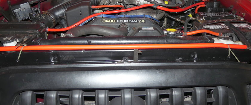

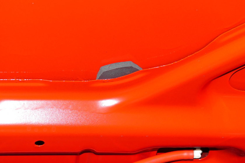

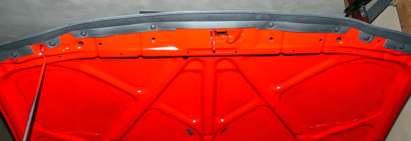

    I am not sure which one or if it was a combo of all did it for me.... I pulled off the old seals & made an outer one from a garage door insulator/weather strip. I had some 10mm hose left from switching out the old tired vacuum ones, & after seeing toyota wanted 30.00 for the inner, I said what the heck. Thing with this is it's a really good fit. I had just painted the hood a few days back & I can just see where the hose meets the hood when it's closed. If you look real close you can see this in the first pic. Other thing I did was take some of the oddball pieces of the garage door insulator & wedged them in where the adhesive was no more between the hood & the support. Just took her for a ride down the highway & it felt awesome to not be all twisted in knots waiting for the hood to fly off....
    The lighting made some stuff look orangey....
    Zippied on for now. wasn't sure it was going to work out & I may try to find a way to afix it to the hood. Who am I kidding. It'll still be there in a year.... :rolleyes:
