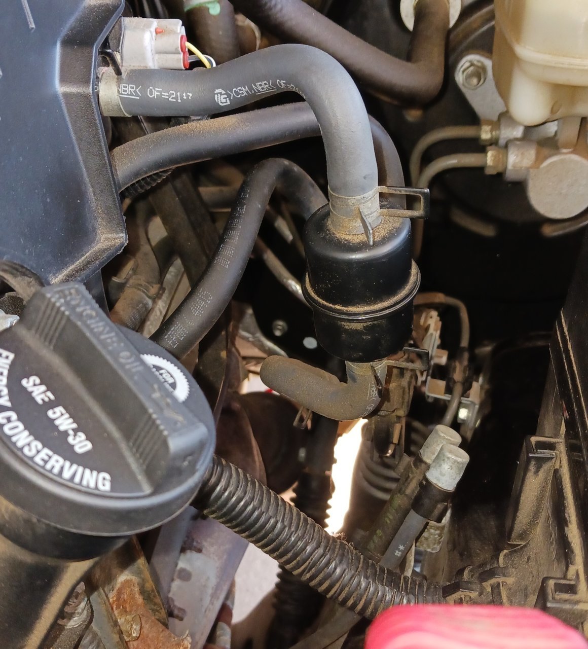

    Tell me about this engine compartment filter: ('14 V6)

    I believe that’s called a vapor tank. I could be wrong, maybe someone can chime in who knows for sure. It comes from Toyota on a vapor hose part number 23820-0c011.

    It's a baffle for the purge line. When the purge valve opens they don't want resonance from the intake manifold to travel up the purge line and affect the fuel tank pressure sensor.
    Manufacturers often do the same thing on the air intake duct between the MAF sensor and throttle body. Smooths out the flow of air across the MAF

    Thanks for the reply, it's position and shape makes me think liquid fuel, hopefully someone not only know why it's there but also if and when it should be replaced. Thanks again!

    It smooths out the vacuum and only need to be replaced if it develops a vacuum leak.

    Thank you for the info, so from what I can tell in these messages the only fuel filter in a 2nd gen is in the tank. If I had concern about poor quality fuel I'd probably cut into an easy access line somewhere and install one. Thanks again for the info!
