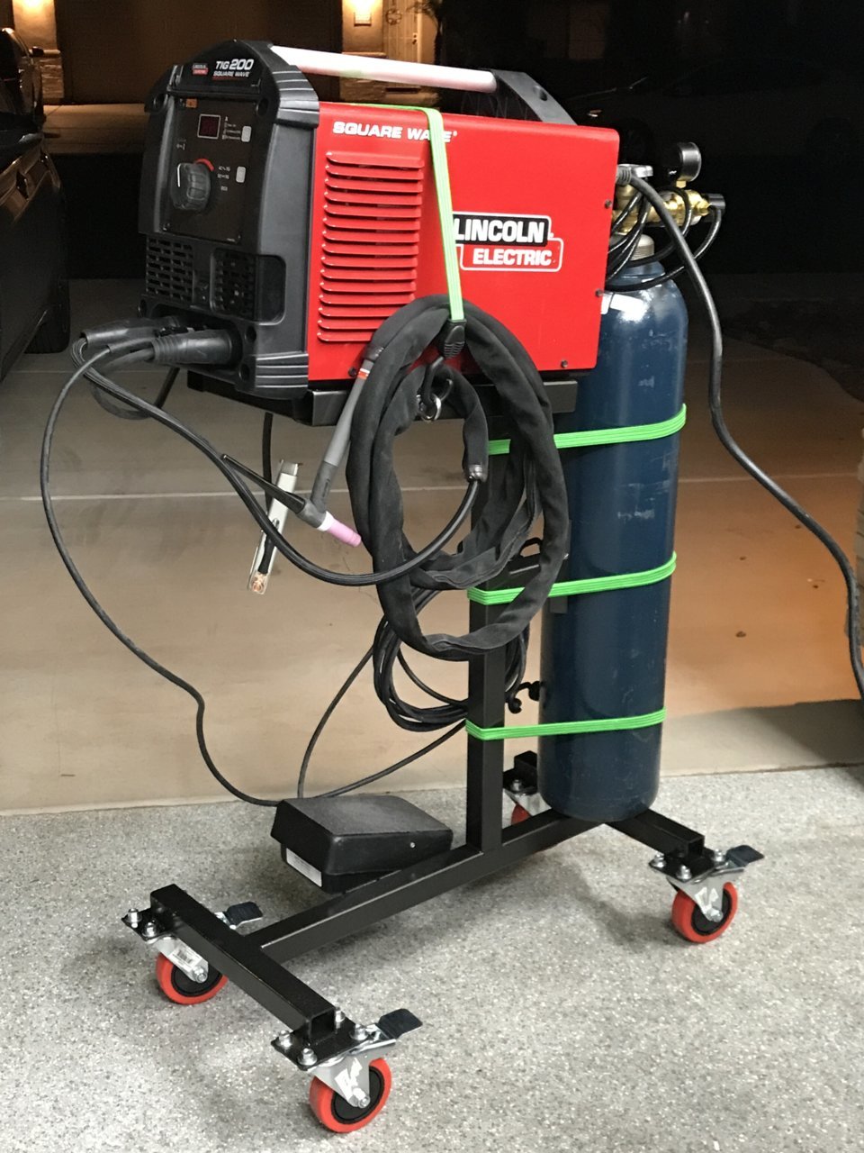

    Like this?

    I love that thing! I love aluminum and that looks great!
