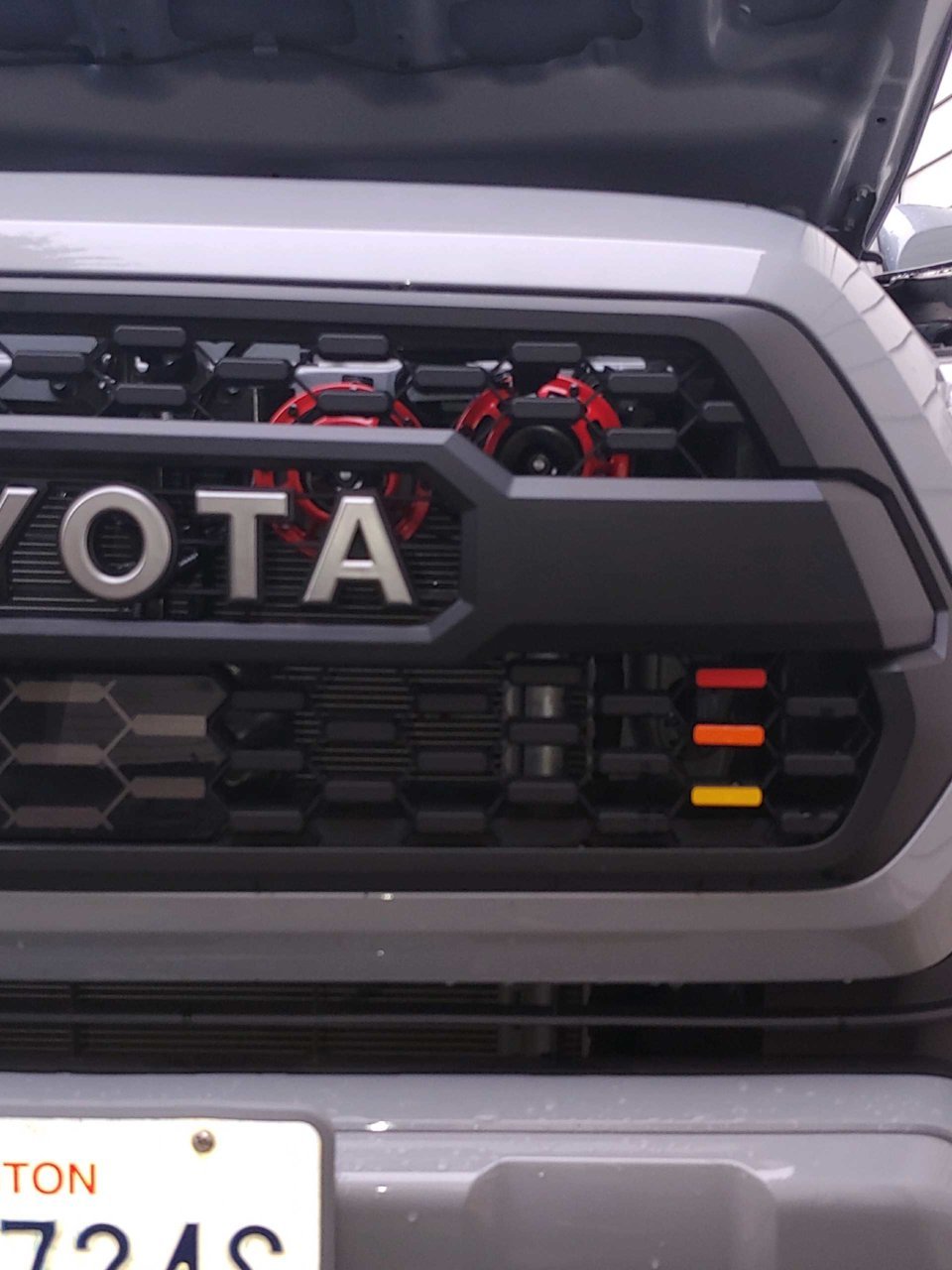

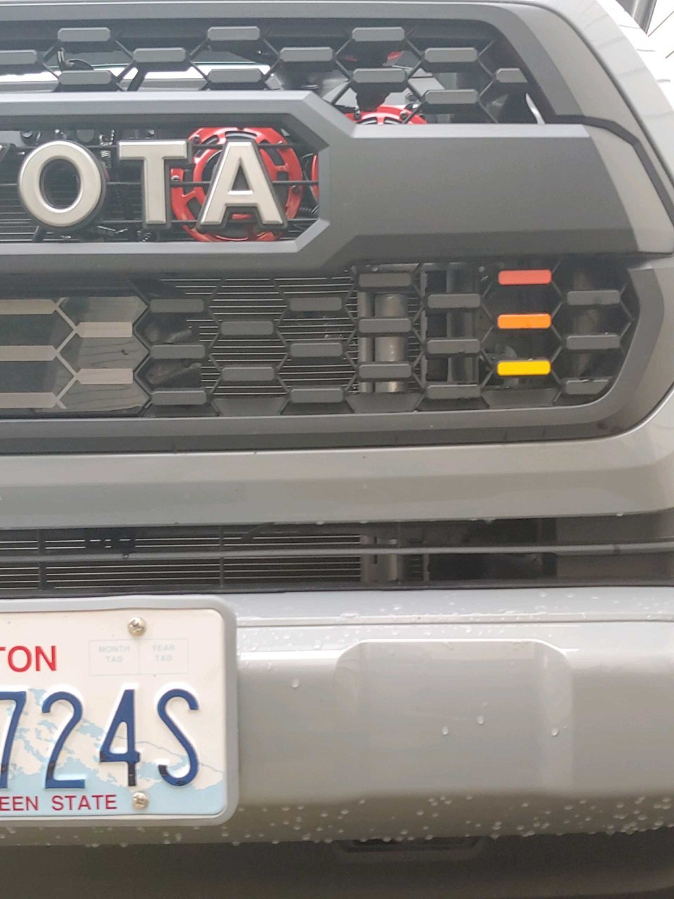

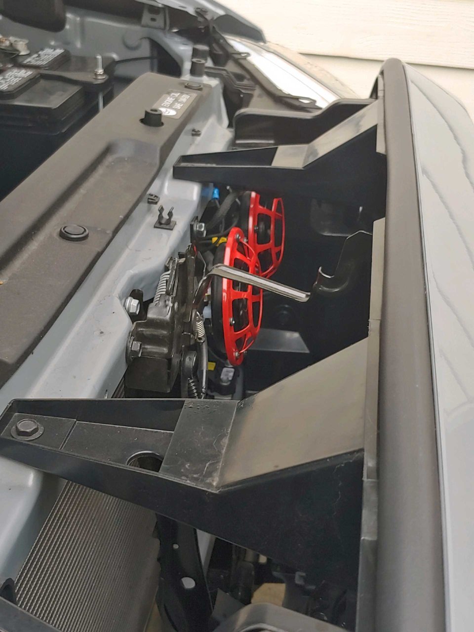

    THAT was easy! Almost plug and play. I made a ground wire harness and wired both terminals of the Hellas is the only extra work I did.
