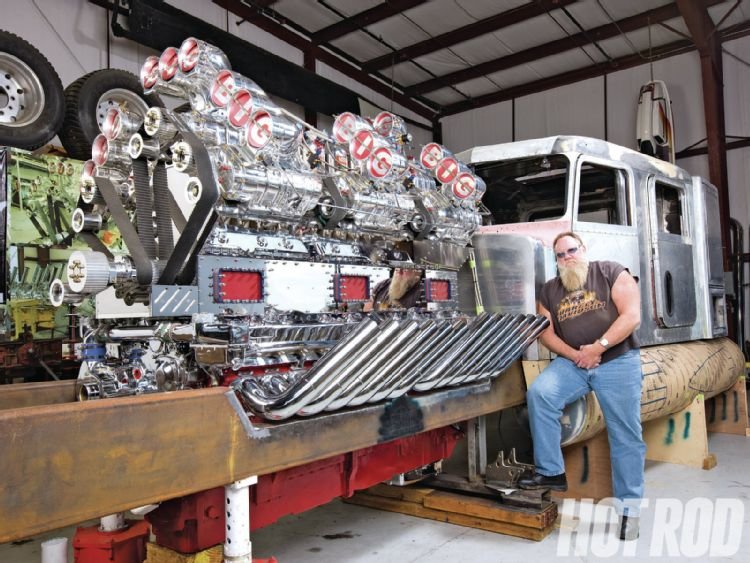

    This should do the trick
    nv529 and Biblite like this.
