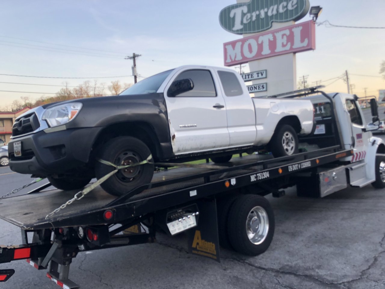

    Hey fam,
    would the 3rd gen 2.7 engine swap into the 2nd gen 2.7 truck? like totally plug and play harness and all?
    got my eye on a 19 tacoma 2.7 motor to replace the blown gasket. On my 13 2.7l tacoma…
    my motor has 320k on the clock btw
