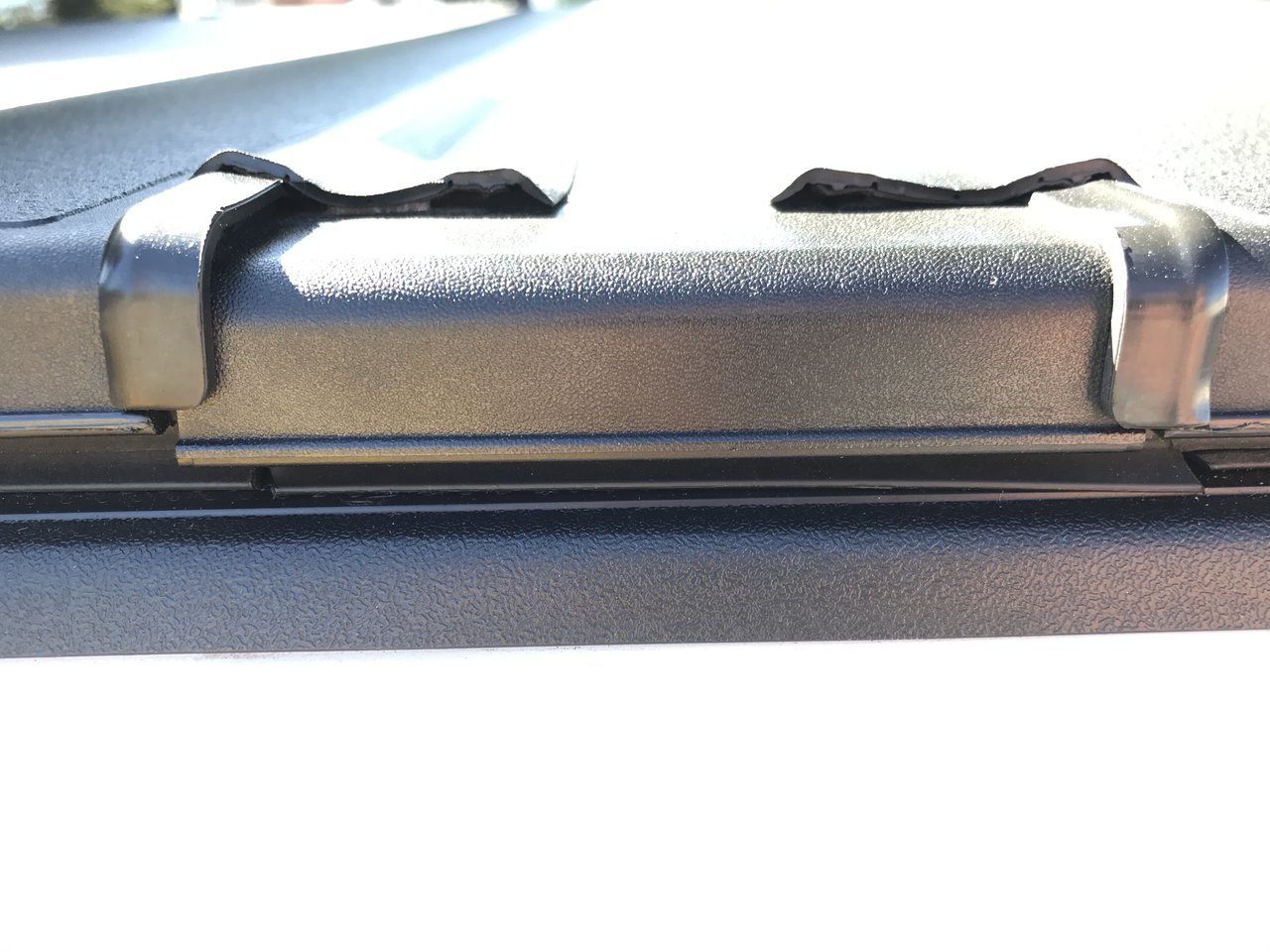

    Yup, that's where I'm talking about also. Mine leaks in front and at all the seams. The cuts in the seal ( where the folds are ) is where it leaks. It's not a continuous weather seal.

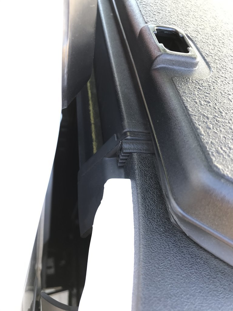

    I used something less permanent at the front. Just used some leftover weatherstripping with sealant applied at the bottom. It gets compressed enough on its own. Toyota has a rubber seal available for this gap I believe. There was a thread on it somewhere....
    Joe, this is where I leak along the rail at the folds and you can see the gaps in the cut seals too. Factory Tri-fold...
