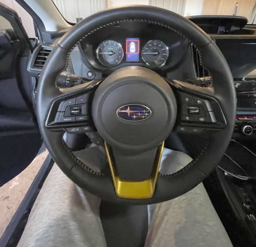

    i have been wondering why the steering wheel is mounted on the side that is closer to oncoming traffic ......i could do a better job, were they drunk when they designed that?

    ^It's so you can see oncoming traffic before crossing the center line to pass on a two-lane road.
    Just be glad the steering column is centered with the driver's seat. In some vehicles it's offset a few inches to one side, GM half-tons, Subaru Impreza, etc.

    yeah, plus it would be easier to try to get your passenger to pay at the drive through window if he's closer.

    FORWARD TO subaruforums.com
