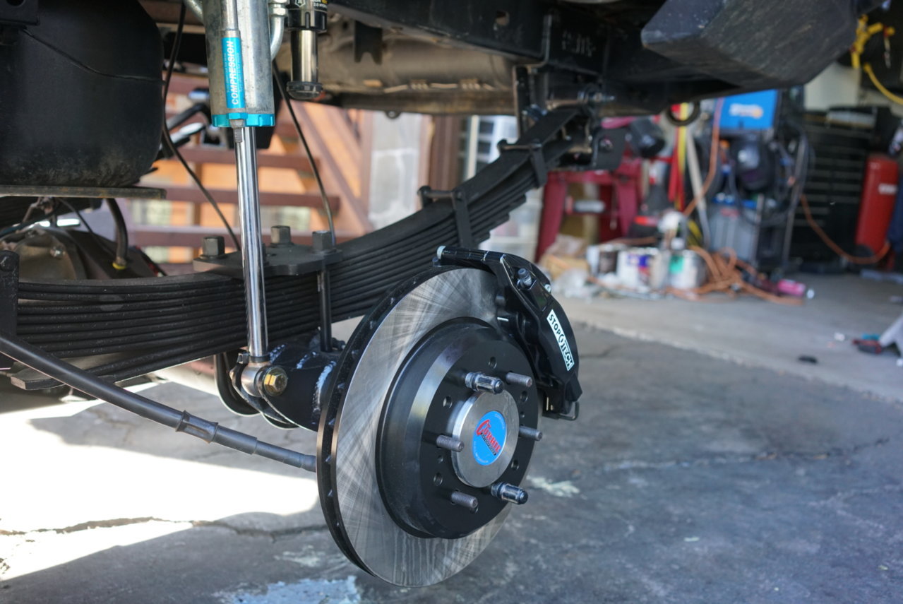

    Options are out there with SOS. Here’s their BBK rear disk conversion.

    Do those retain the ABS and the parking brake? I'd love a cross drilled / slotted rotor that came with all the bells and whistles.

    Yep. The e-brake uses 4runner inner brake shoe hardware that goes inside the rotor. You have to bring in the cable adjustment under the center console a bit, but its easy. ABS tone sensors are on the axle itself so that doesn't change and still works as factory.
    More info here if you care:
    https://www.tacomaworld.com/threads/installing-a-currie-ford-9-in-a-tacoma.545890
