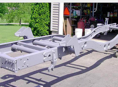

    Dump trucks, big rigs, and unimogs have open c-channel frames, just like our Tacomas, because they are better by every single metric.
    Unimog frame:

    Man, I’m digging the pipe cross bracing. No need to brace the flanges.

    The Unimog is awesome, but it's 50% tractor.
    It's frame is not better in every single metric, its better for hauling big loads off road at low speeds offroad. That's the only situation where a flexy frame is good.
    We're talking about a Tacoma here, its 0% tractor.
    A rigid frame is better in ride quality, handling and composure. The next Tundra and Tacoma will be fully boxed, because it is absolutely necessary to increase load capacity, modernize it's ride and composure, and keep it light.
    Let the suspension do the flexing
    I don't knock C-channel frames, if they're done right. For instance, the 92-93 Dodge Cummins frames are 8" tall, 1/4" thick, and beastly BUT heavy, no one cares on a Diesel work truck.

    The frame is better in every single metric. No question. Open C-channel isn’t a just a technology, it’s a lifestyle.
