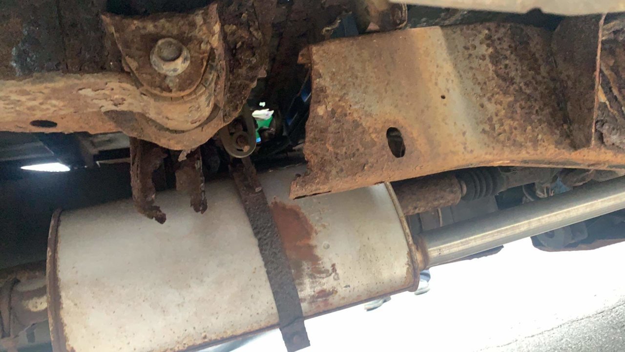

    I heve seen rusted out fullsize truck frames that look worse than my Tacoma, which the frame isn't that bad looking.
    Surface rust does not look as bad on the frames that are larger.
