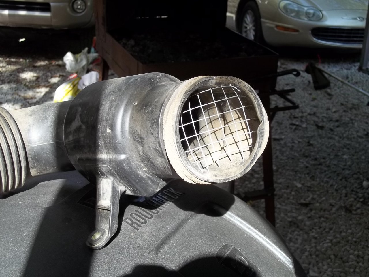

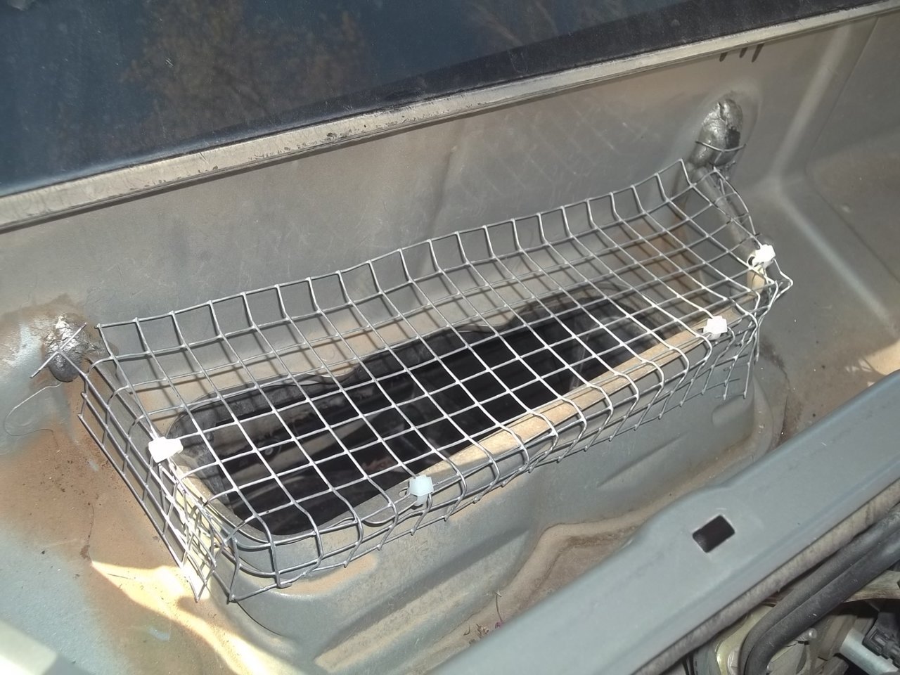

    Put some 1/2" hardware cloth (aka hail screen) in the opening. Works on the cabin fresh air intake as well.

    We’ve seen that kind’ve wire used and chewed through. It’s important to get a steel mesh that has small spaces so they cannot get their teeth and jaws in there to chew it.

    Put a steel mesh over the inlet where it goes into the fender well. I did that because I had a brand new air filter chewed up. Ozarkie has pictures in his post do both of those spots.

    any steel mesh used needs to be ~.25" square. I used some expanded metal that was ~.25X.5" diamond openings, I could only get half my pinkie nail into it, and a mouse cruised thru it.
