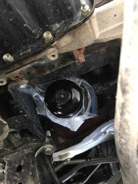

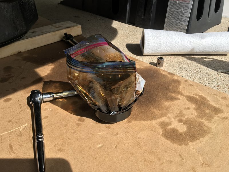

    I used a quart sized ziploc, and maybe had a teaspoon worth of oil that escaped. Couple drops hit my arm, the rest hit the flattened cardboard box I was laying on. Beats the alternative, that's for sure. I slid the bag over the filter, then used an oil filter wrench (see first image) on top of that to remove the filter. Worked quite nicely, think I'll stick with that method for now.
    One note - first image shows the bag outside of that heat shield bit, however it quickly became apparent it wanted to rotate to the inside of it, so definitely start with it on the inside of that.
