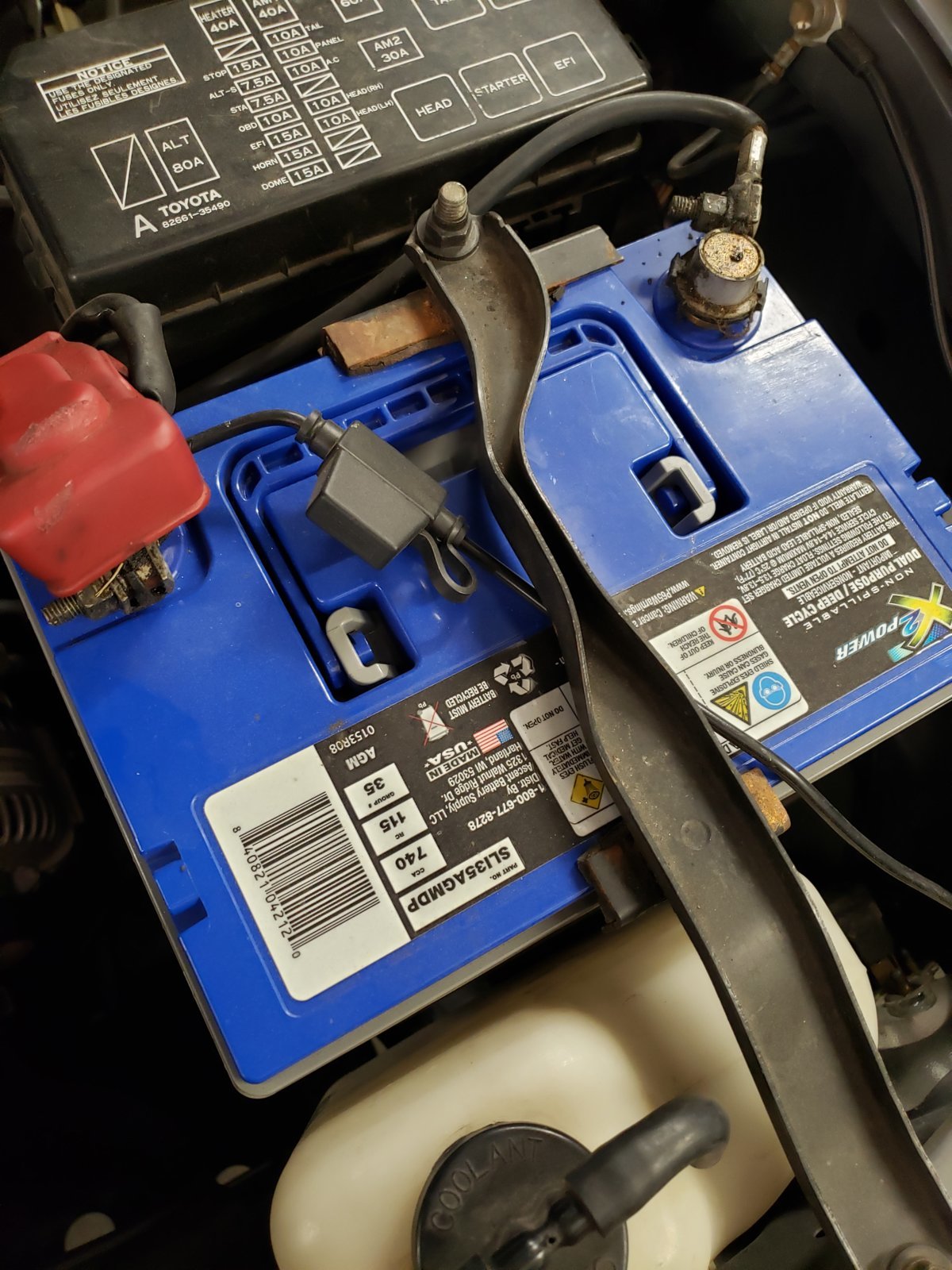

    My '95 has an X2Power AGM since Dec 2019.
    Gets driven once a week for errands in town.
    Never been hooked to a maintainer but she lives in climate controlled garage 65F, currently.
    Drove her yesterday with about five stops. It was around 35-40F ambient.
    It's a little low, but my NOCO 5 went right to green when I plugged it in.
    Group 35. Totally stock truck.

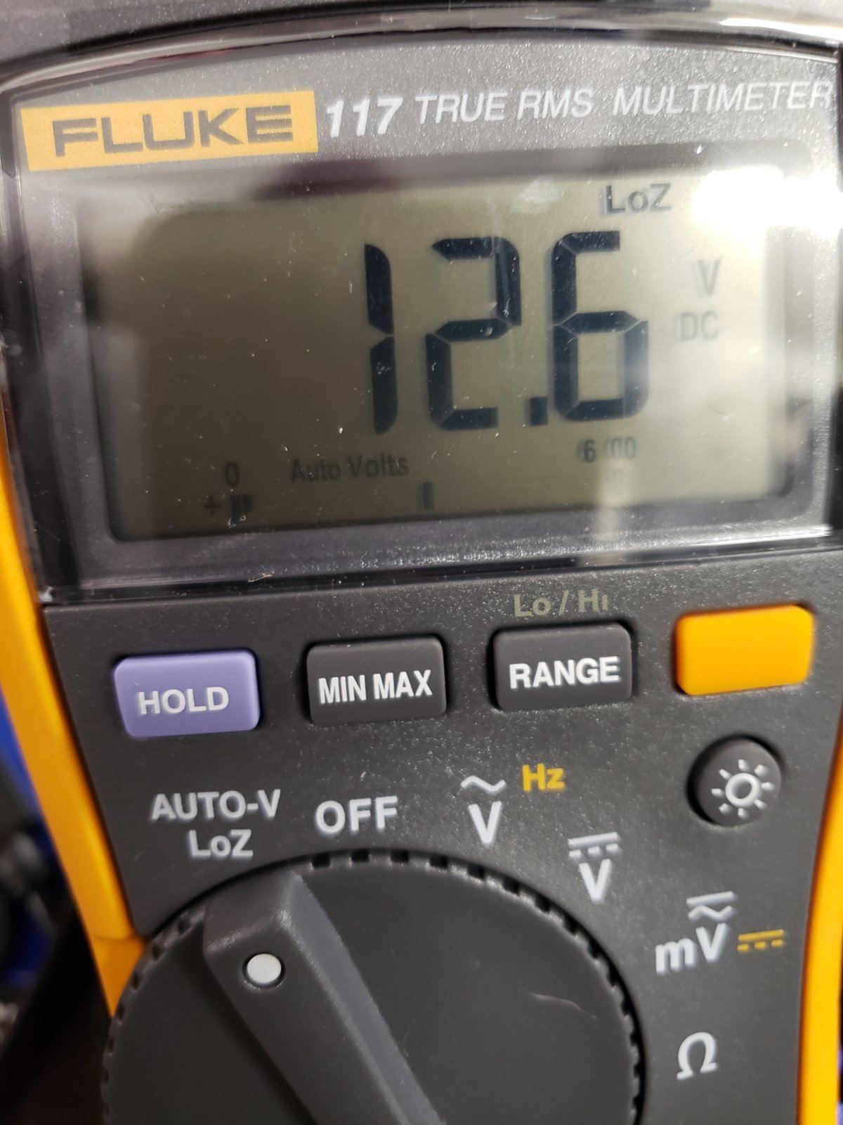

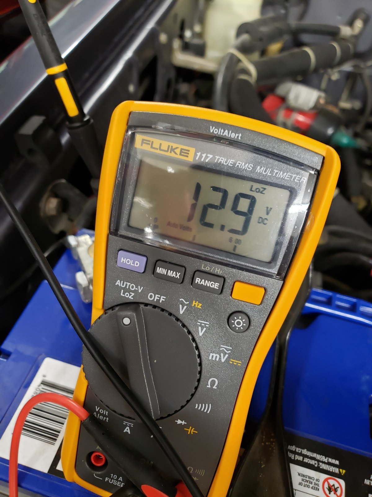

    I have a big X2Power AGM in my utility-class tractor that lives under an overhang. Checked it early last winter and it was reading 13.0v. I'm south of you, and our weather is totally random, but never deep cold for extended periods.
    I do connect to a maintainer Dec-Feb, but that's a pretty big diesel.

    Thanks for that pic! I was wondering if the Northstar 27 was a drop in fit.

    How long had it been sitting when it read 13.0v? I've never had any battery sit static at 13.0v for more than a few seconds. The Odyssey batts in my diesel truck drop below 12.6v within a minute of shut down. I can definitely tell that the AGM in my Tacoma is under charged. It only gets driven occasionally and for short distances. Max charge output shows about 14.2v, not enough to keep the AGM charged up.

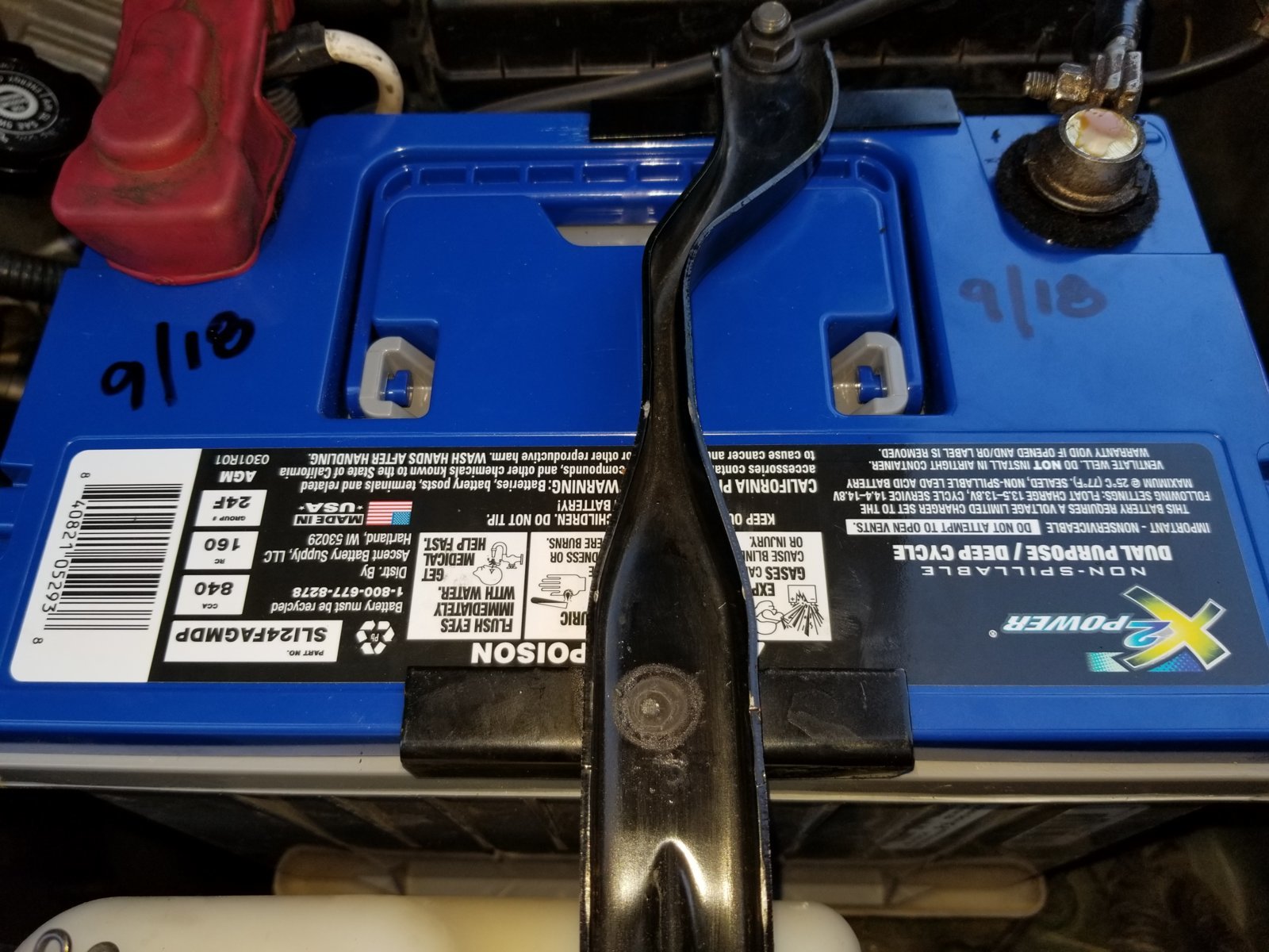

    @Jermzfree I incorrectly labelled that picture of my 1G Taco battery as a Group 27... it's a Group 35. Apologies. I have corrected the original post.

    I don't recall how long the tractor had been sitting.
    But I did go back through storage and found that I completely neglected to hook my FJ60 up to its maintainer when it was put away over Thanksgiving weekend.
    So seven weeks later, this is what I got. Obviously zero drain in that old rig. Again, stored inside climate control building. Group 27
    X2Power AGm, purchased in Dec-2019.
