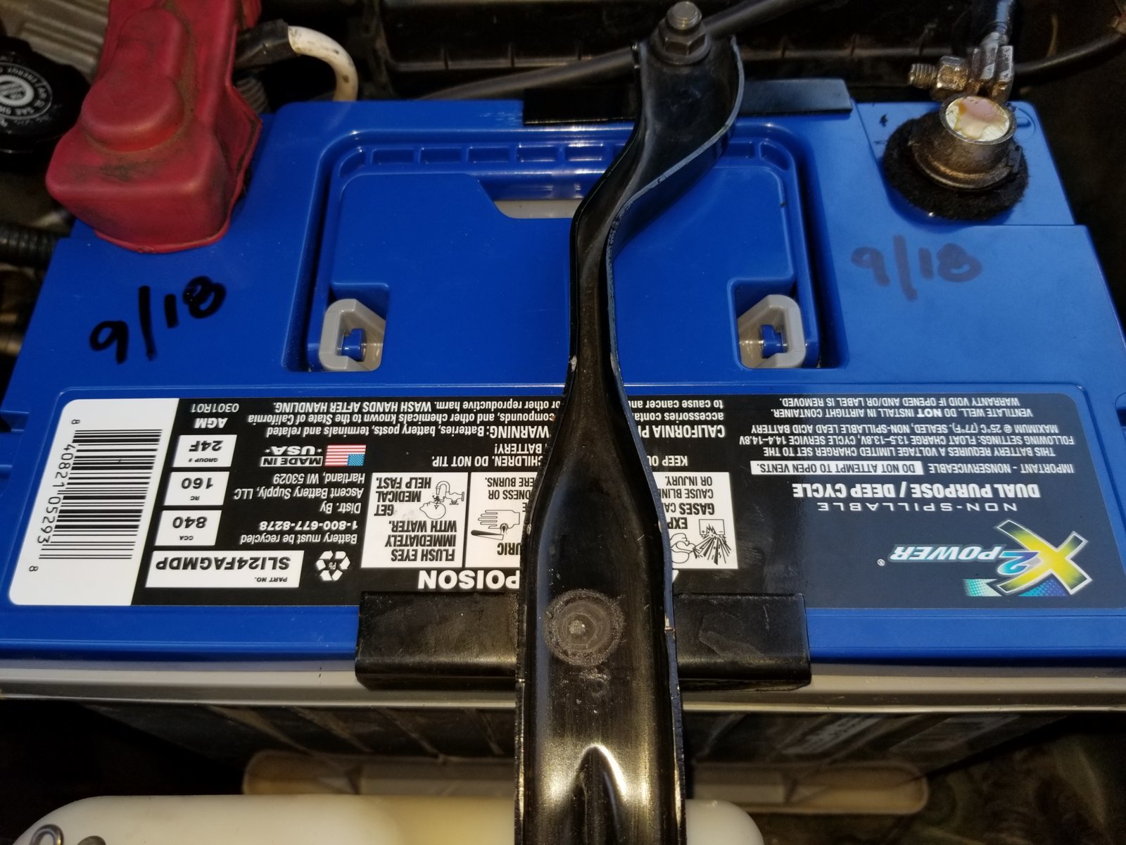

    I put in my booster and went through several days of probing to make sure it was working properly. Once I figured out it was good, I dropped in my new X2Power 27F. These are a awesome upgrade.

    Yep, it can be done on the 1st Gen, I run one on my 1st Gen with an X2 Power 24F. There are many different products to boost voltage using the Alt-S circuit, you generally want something that will put the voltage at +0.5v (not higher) and retain the factory fuse.

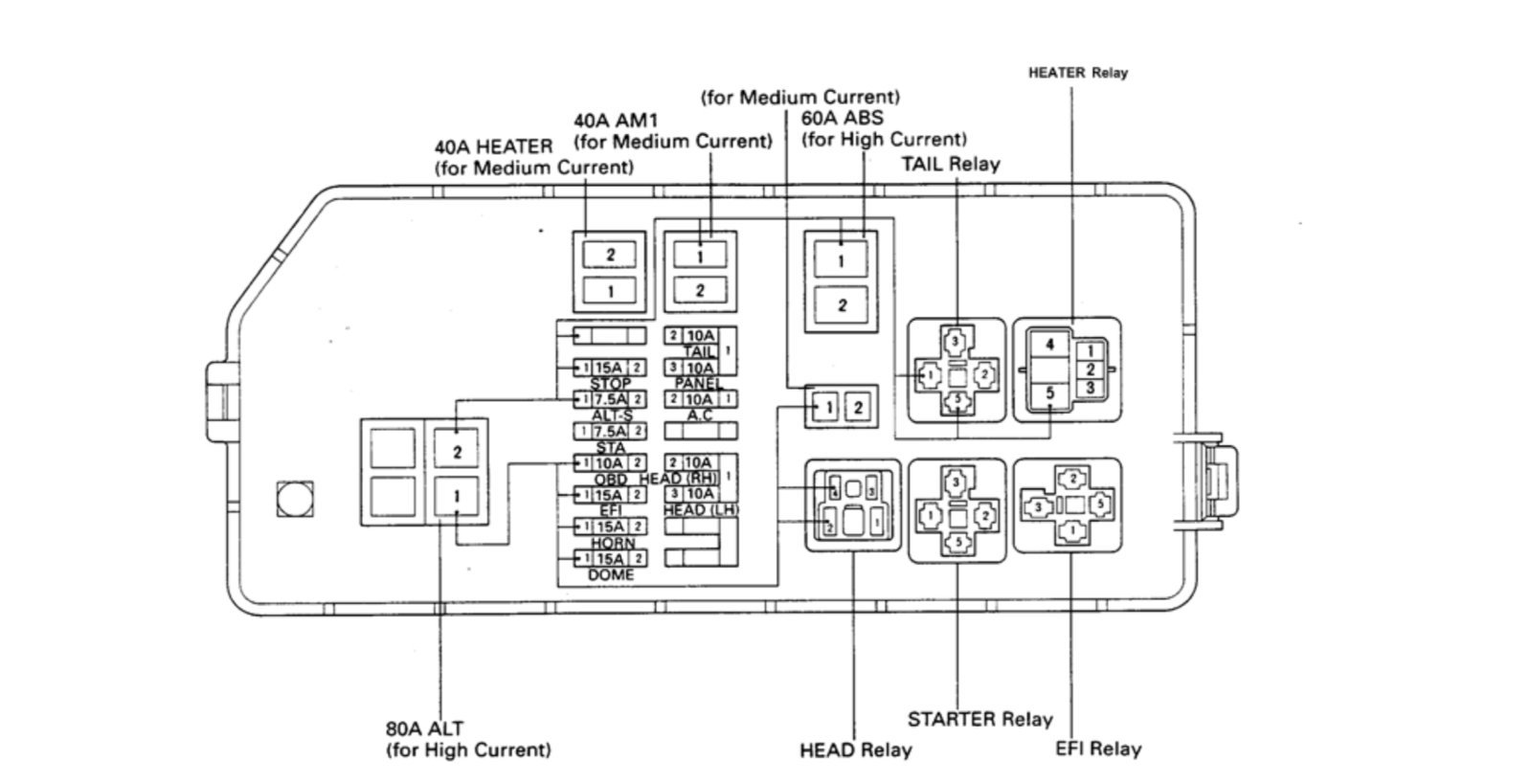

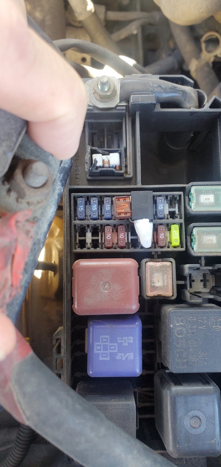

    None
    Awesome! Please do me a big favor please (and anyone else interested in this mod) and point me in the direction of the fuse location?!? Thanks!!

    TnShooter
    TnShooter The TacomaWorld Stray
    Sep 2, 2010
    #42625
    21,145
    Deogee
    07' TRD Off-Road, Auto
    STOCK
    Under the hood.

    An AGM will work without adjusting the charge voltage, so many say I ran an AGM and it worked fine. However, you will not get the optimum performance or life out of the battery you are paying a premium for. Might as well get a cheaper lead acid. Undercharging leads to sulfation which reduces battery performance and eventually causes early failure.

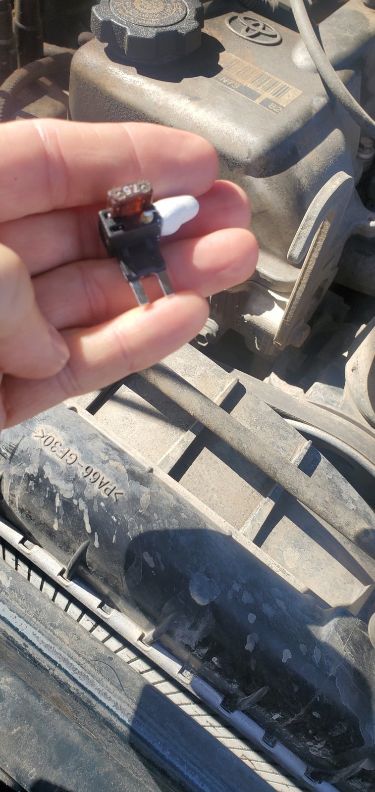

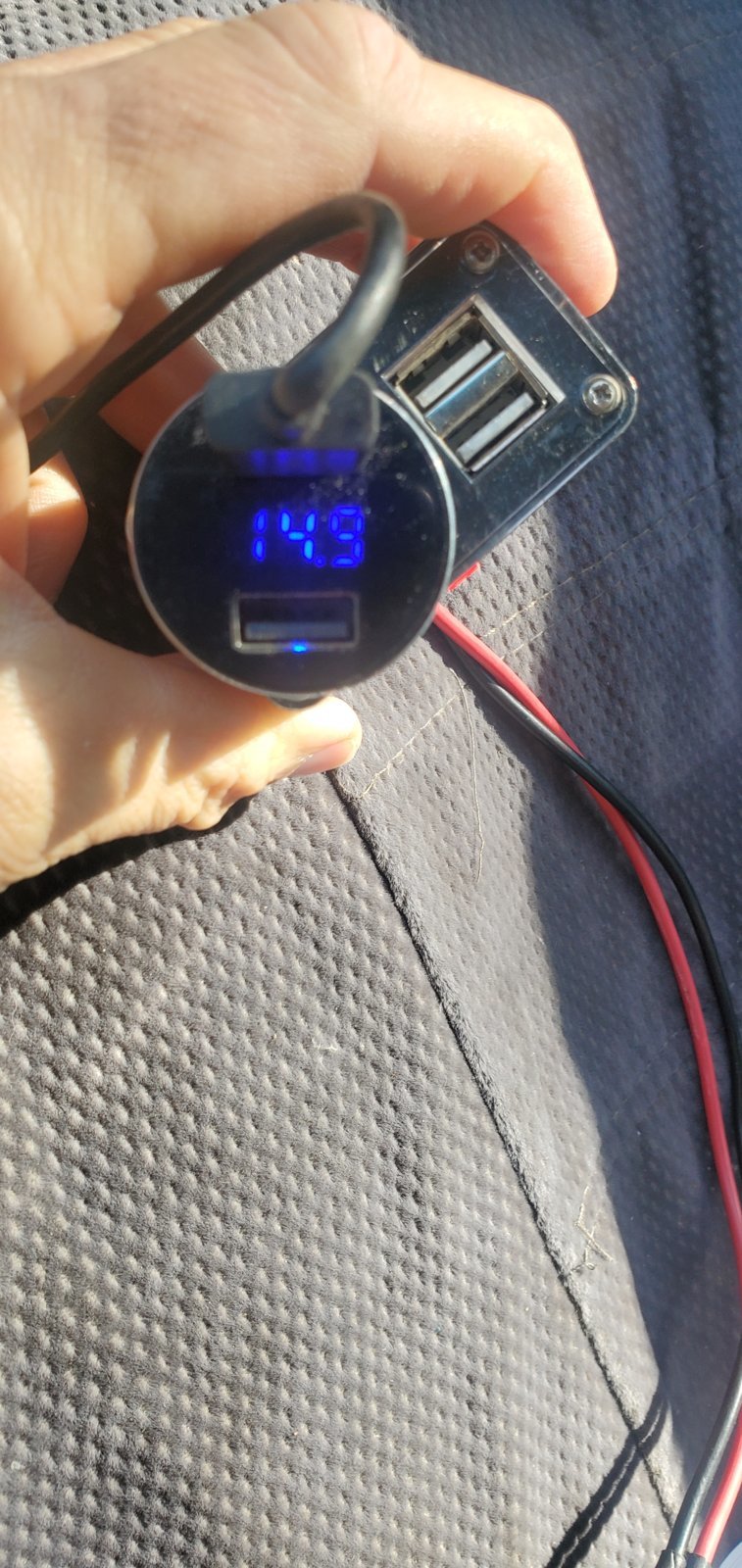

    https://www.ebay.com/itm/2663218193...vK7lI1nSm2&var=&widget_ver=artemis&media=COPY
    This is the one I bought and it was like 1 day shipping because we are both in San Diego. Anyway I bought the GM diode and I was getting 14.0 no mater what the orientation. I was waiting for the battery light to come on since I tried both ways. I’m going g to take it to work and measure the voltage drop on a proper dmm. I’m just using a fluke hand held at home. And it reads .5ohm oh well I did pay $10 on Amazon because i was too lazy to drive to Napa. Well at the same time I bought this one and I plugged it in with the 7.5A fuse and used my battery tester and monitored the charging voltage and it was at 14.2V I also monitor the voltage on my scangauge and it was solid at 14.2V
    so bottom line even tho I can make this for parts I already own I just decided if it works it was worth the $30.

    I ended going with this option and it works great. I like how it retains the fuse. The voltage is now at 14.9 volts. Thanks for all the good ideas much appreciated. :thumbsup:
