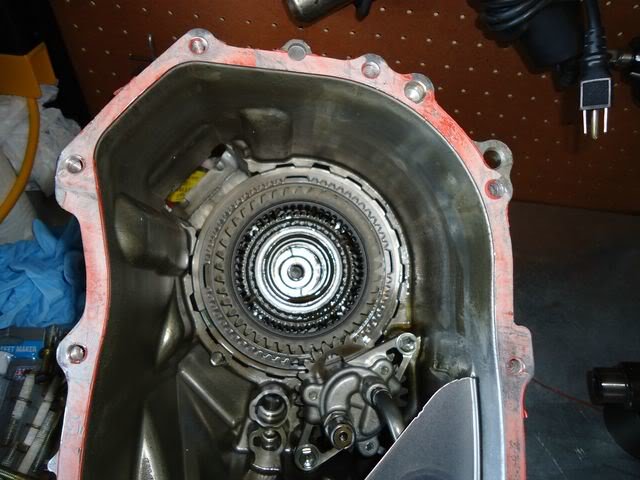

    See below, as my post is not invalid. Have you ever had a transfer off the truck and tried to just spin the back output shaft, you'll notice the front input splines do not spin. The oil pump is driven off the front input shaft. If you want to flat tow your tacoma go ahead

    Let me make this *incredibly* simple for you;
    The input shaft is *ALWAYS* turning, which means that the transfer case pump is *ALWAYS* pumping, just as long as the wheels are turning.

    You're quite welcome sir, I find it funny that it is so hard to convince him. I've taken these cases apart before, I know what's in there. The input shaft is not a direct pass-through, if it was how would the gear reduction be engaged to the rear. But whatever, I'm not sure why this is even an argument, the manual states that this is not a method of transportation that should be implemented for long distance towing.
