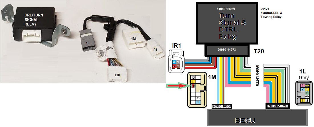

    I suppose if you tricked the DRL circuit (Pin 12 Light Green/Red) on the DRL/Flasher module you could get them to stay on with the headlights but I can't find what kind of signal it uses, I suppose you could measure it with a multimeter with the Headlights on and off and see what signal turns the DRL's on.

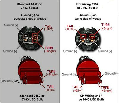

    The 2012+ uses a dual filament bulb which illuminates as DRL/Turn (High) and Parking (Low) which most confuse with both being ON after Low beam is selected when actually only the LOW filament is ON with headlights ON.
    OP, you could install a dual filament bulb and add the terminal & wire tapping the side marker (parking circuit).

    Yes, they do. Remove the bulb you have now and look at the pins that mate to the bulb base. The type of set up dictates the bulb type needed.
    Test they pins to the missing terminal on the wire side.

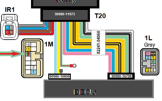

    I haven't tested it, but my guesstimate on this would be that the turn relay does the switching of steady DRL to intermittent TURN. The DRL is activated by the Body ECU providing ground when IGN is ON and the Parking Brake is released. Then interrupting that DRL ground when the Headlights are selected.
    If that can be confirmed, then all that would be required would be to permanently provide a ground to the DRL wire of the turn signal relay. (De-pinned or cut and insulate the DRL wire to the Body ECU and crimp a ring terminal to the wire and fixate to a proper ground.
