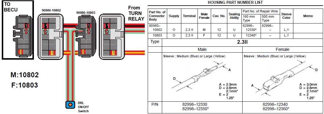

    Disable the DRLs

    That worked like you said thanks

    My truck was born in a time before DRLs.......thankfully. The ebrake thing seems like the best answer....if sitting. Tryin to go stealth while rollin up, mod time

    OP, do the Crom DRL switch add. It's easy.
    Cut wire, crimp connectors to each end and added wires to a on/off switch
    or assemble this so no cutting the OEM harness/wires.
