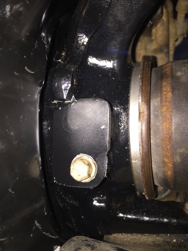

    If so, can you please take pictures of the back side of your spindle on the opposite side of the caliper? Trying to see what you guys have regarding the ABS speed sensors.

    Right here, where the ABS speed sensor would be:
    This is on the drivers side.

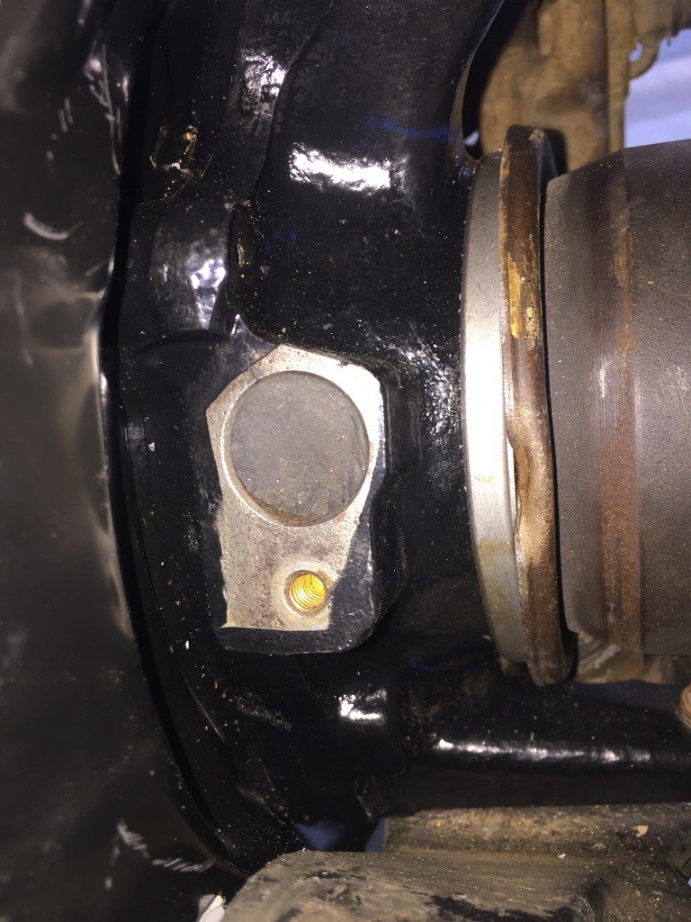

    Just found this pic in your thread @jubei777 posted by @TMFF
    Cant tell if you have different spindles or a block off plate though.

    It sure looks to me like there are different spindles for with and without ABS. As in two different castings. Let me look thru some pics from my Tundy brake upgrade...

    I don't have any pics from that angle, Mike. But based on Ben's picture above, I'll bet Toyota used the same casting/forging and then machined the interface for ABS equipped trucks.
    Not sure if that helps :oops:

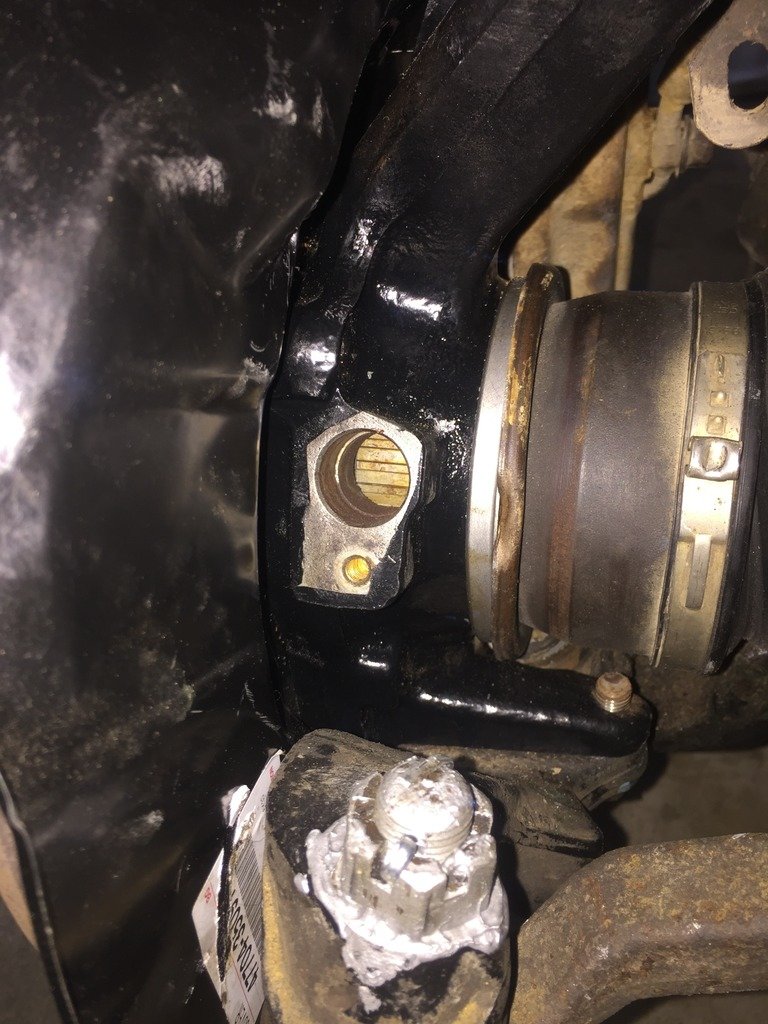

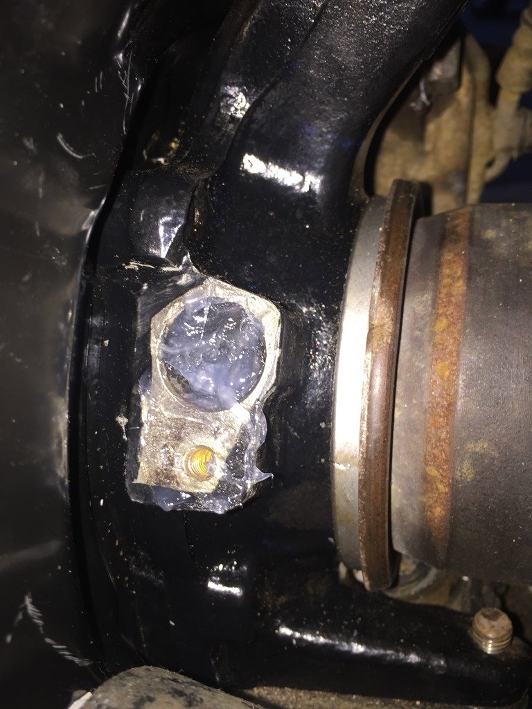

    Here was my solution:
    Rubber stopper:
    Adhesive RTV:
    Block off plate:
