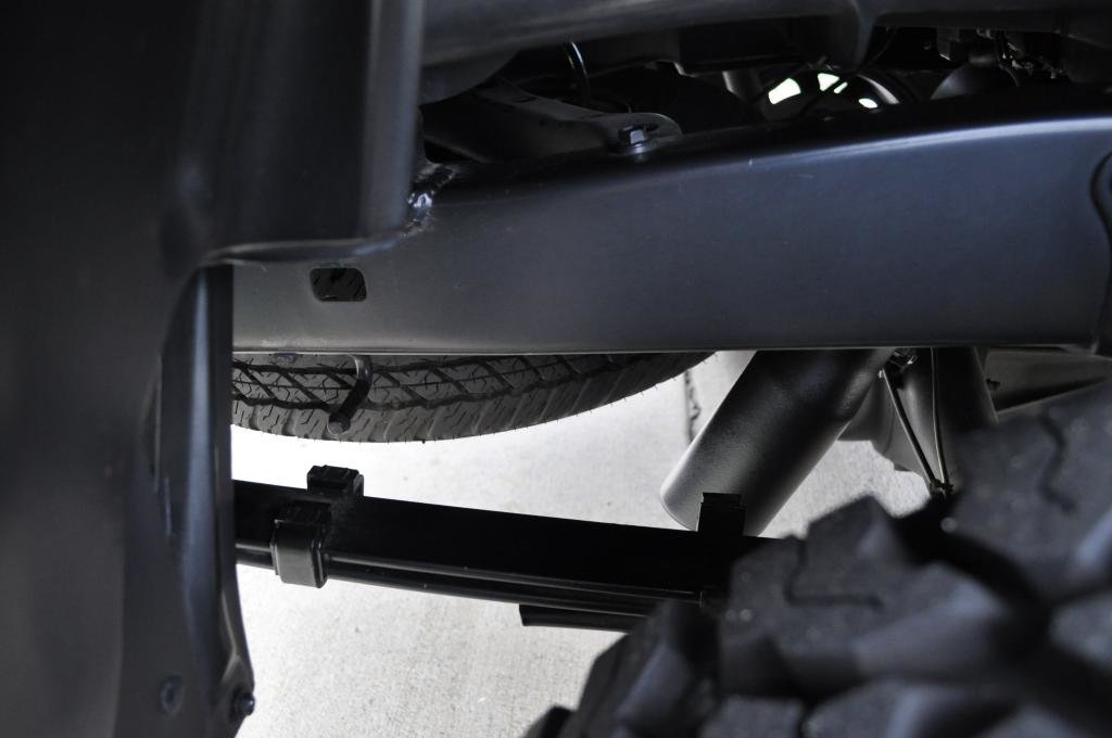

    Cut mine with a sawzall using a metal blade. Took seconds and came out really smooth
    Used compound cut roughly a 45 degree slash cut down and 45 to the outside. Sprayed it black, and you'd never know exhaust was there. No issues re noise, fumes , etc.

    I think I'm going to do that this weekend. I'll borrow my dads sawzall. Must be the only tool I don't own lol. I think I'm going to put a tip on mine and paint it black.

    So you're in the clear. Hack it after the dump over the axle. Piece of advice: Take a file and some 1000 grit to the cut edge afterward, otherwise an errant hand the next time you're working in that area may get cut way the fuck open. I guarantee the odds of that are higher than carbon monoxide poisoning.

    Done! Looks a shit ton better. Wish I would have done it sooner.

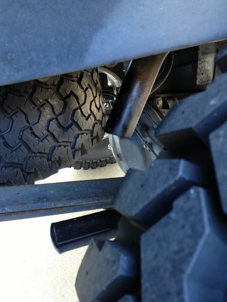

    On a side note, does anyone know if a TRD catback exhaust will sound any different if it is cut after the axle like Turner's above me?
    I am just curious because I may get a H/C bumper at some point or may just want to "hide" the tip of the exhaust and don't want the sound/performance to change.

    I did mine last week too - to fit my 285

    You probably won't want your exhaust breathing directly on your spare all the time.
