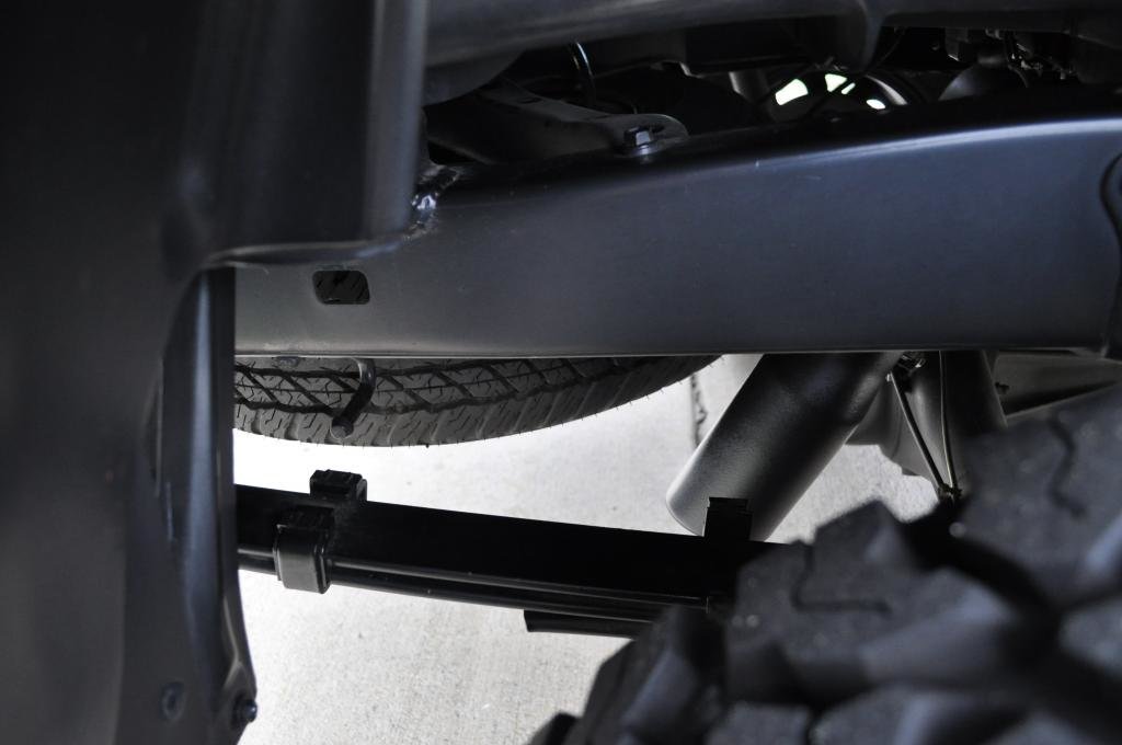

    Installed a TRD, catback exhaust, on my 2011, TRD, Off/Road, with 1025 miles. Prior to installing, cut the 2-1/2''OD, tail pipe off, 3-1/4'', behind the muffler, with a die grinder. Filed the cut edge down. Took the exhaust, to a local muffler shop. They took a 2-1/2''OD, exhaust pipe, measured out 4'', made 45 deg bend. From the center of the 45 deg, measured, 3-1/8'' & cut off. The end, sliding over the 3-1/4''L cut, was flared to 2-9/16''ID. Using the die grinder, cut 2 parallel slots (1''L X 1/8''W), 180 deg, offsetting. Slide the turn down on, angled it 1/2 way between the ground & axle housing. Installed a clamp (the 2 slots allowed for a snug fit). Nothing is noticeable, unless you lay on your stomach & look upwards. Clean set-up. No highway drone, no noticeable sound increase, unless you get down on the gas & that is not that loud. Has a good overall sound.

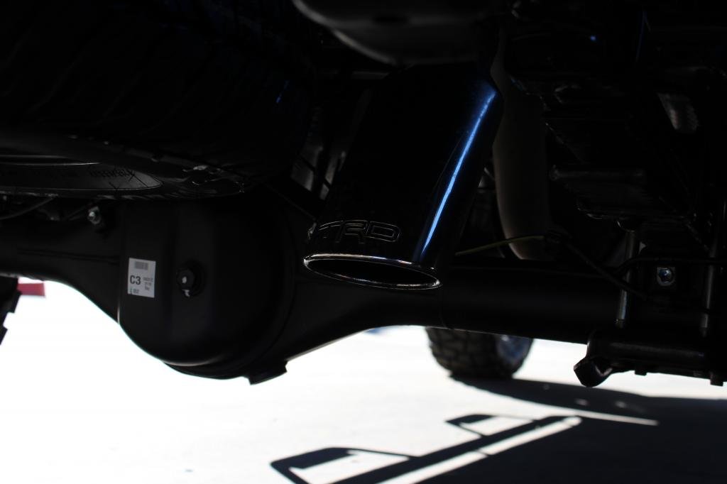

    So is everyone that wrote in this thread still alive? I Plan on doing this relatively soon and having my TRD Tip welded on the way datsik did?

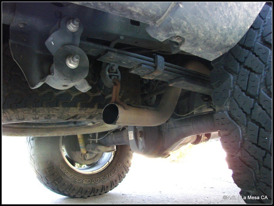

    About 2-minutes with a hacksaw (new blade). I still need to file and sand it for safety. :D I like the new sound! That was unexpected.

    one of the easiest cheapest off-road mods you can do.
    I ran my old 92 like that for a long time.

    It has more drone on take off. I did not expect the sound to change from only removing 18" of pipe, but there it is...
