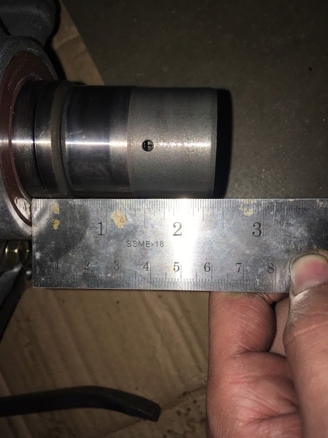

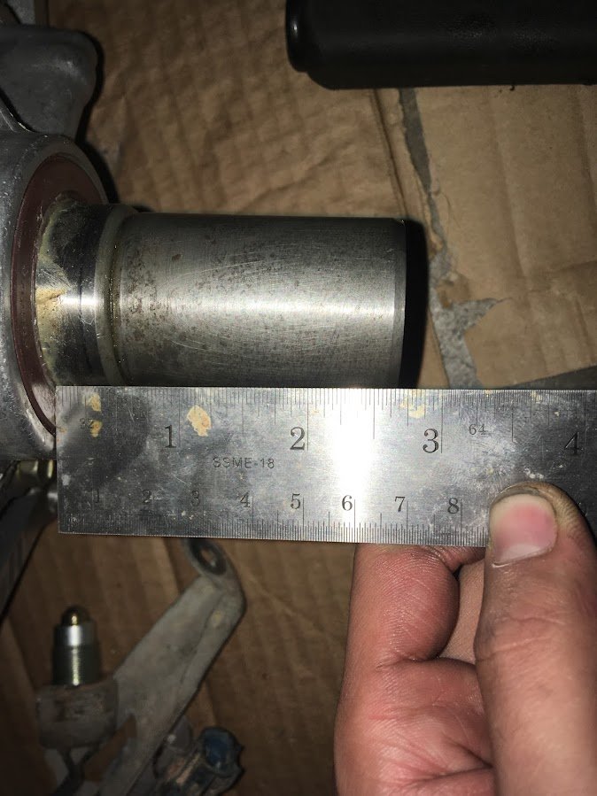

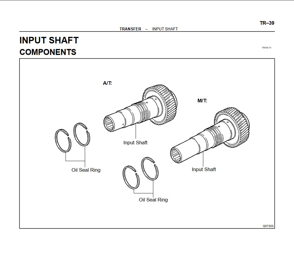

    Was about to start my own thread on this one. I have a pile of R150Fs and manual transmission 3.4 J-shift tcases. But only one automatic 3.4 J-shift case (which was installed in my 04 double cab). Many people choose to run their 3.4 automatic transfer case with an R150F after a manual transmission swap. None seem to have had issues. But what about running a manual trans 3.4 tcase on an automatic?
    I pulled some full service manual pages that seem to point to the two cases being almost identical besides shifters and indicator plugs. But I've also noticed some other differences. I haven't been able to find any concrete information on the internet regrading this. My best bet might be rebuilding the 350K mile auto 3.4 transfer case. Feels wrong having such a high mileage part on my clean 140K mile truck.
    3.4 V6 Manual Transmission Transfer Case
    3.4 V6 Automatic Transmission Transfer Case.
    Has that hole and a shorter input shaft.

    I would remove both those couplers and count the splines. The diameter of that coupler matters more than the length anyway. If it was my truck if the splines matched, the input shaft diameter matched and the only difference was the length of the coupler I would slap that on my "new" tcase and let it rip.

    Looks like I'm good to give it a shot tomorrow. 23 spline because they're both off V6 trucks. Same diameter.
