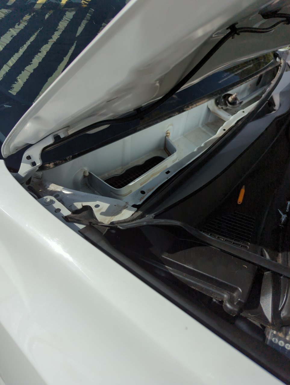

    Is there supposed to be a piece that deflects water from my cabin filter intake under the cowl? We were getting water in the passenger side floor board in our new/used Tacoma and this is what it looked like under the cowl.
    When it rains, it is dripping through the cowl into that intake...sigh. He is rigging up a piece of metal to deflect the water now but seems like there is a part missing because it does have 2 screw holes. Thanks!

    If the windshield has been replaced, maybe the installer did not put it back on.

    You’re missing a plastic cover that runs across the back (side to side) you need to find one and install it.

    Disregard my previous post. I don’t realize I had responded in the 3rd Gen section.
    I don’t know what is supposed to be there on a 3rd Gen.

    You’re definitely missing a part

    There's something that looks like the grille cover laying in front of the cowl with the the little pencil in it.

    Yeah that's what I was unsure of. Those other parts except for the cover are probably metal also. If that's the case it looks like nothing is missing.
