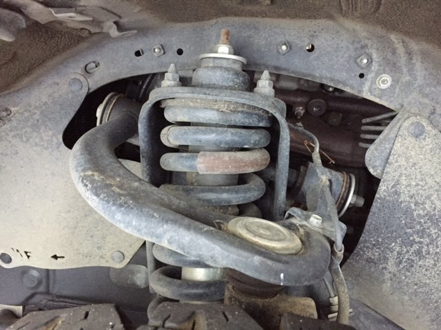

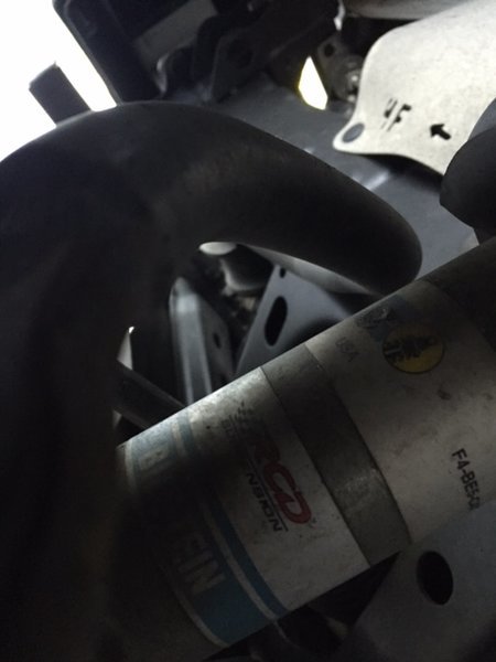

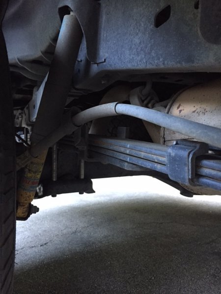

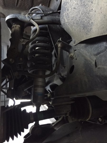

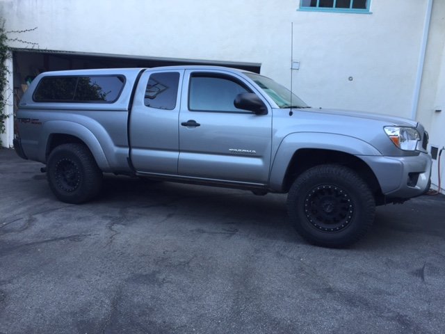

    Hi everyone. Im trying to figure out if my new 2014 Tacoma has any suspension lift up front or is it all stock. Most stock tacoma front shocks ive seen are yellow which leads me to believe this is aftermarket. (Bilstein 5100 lift? Front shock says rcd suspension?) And the 265/75s seem to have plenty of room and no rubbing. 31's rubbed on my old tacoma pre lift. The rear seems to be stock, factory shackle, dont see an aal, no body lift but it has always looked to be a little higher up front than stock. Any way I appreciate any and all help. Thanks!image2.jpg image1-1.jpg image3.jpg image5.jpg image4.jpg

    You are correct. Rear is stock, front is aftermarket bilsteins making it level

    Thanks! So this is the o-2.5" leveling kit? Is it possible to tell what its cranked up to by chance? Again i really appreciate the comments

    Ya 5100's.If you can look in there are 4 notches for the clip to sit in.
    .85
    1.75
    2.5
    My dbl cab only needed second notch(.85) to level out with canopy

    yezus...... those poor stock leafs without any help are frowning upsidedown with just the topper....

    Yea i just put 170lb sliding tool box and almost 100+lbs of tools out back. Next id like to bring the now sagging rear up an inch or so and/or beef up springs. So don't know if i should get an aal or something more substantial for weight/ future weight. Really dont know much about leaf springs. Don't really want to buy new leaf packs but if it'll help ill go that route. Any ideas would be appreciated. Always loved my tacomas cause they're so light/ agile but now its all loaded down lol but i gotta work

    Check out sumosprings for the rear. I'm leaning that way for sure
