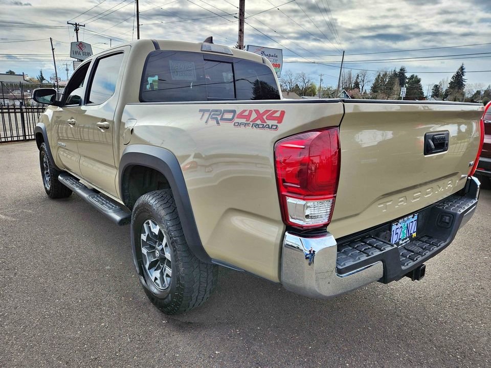

    Hi Guys,
    Newbie here. And new to Tacomas.
    I made an offer on a 2018 Toyota Tacoma Double Cab, TRD, 4x4 Off Road. It has 152K on it. They accepted my offer of $25K pending some repairs. I was a bit surprised by how many miles on it for it being a 2018. It was also bought by the dealer at an auction.
    The Good:
    Truck is loaded. Has all the features I expected. I took it to my mechanic and he thought it was good (again pending some critical repairs). Clean CarFax. And appears that all normal maintenance has been done. Test drive (with my mechanic) was positive, ran strong, no obvious problems.
    The Bad:
    Oil leaking from front/timing chain seal. I know this is a huge job (20 hours, $4K+). It was also throwing a Bank 2 Catalytic Converter code.
    I told them that I'd be good on my offer but they'd have to fix the oil leak(s), catalytic converter, and put on new front brake pads (currently at 25%). I told them they needed to use Genuine Toyota parts, Toyota FIPS, and show me receipts and pics of the work.
    Sooo--I don't know much about these other than what I've been reading. Is this type of oil leak common. Am I asking for problems? Or are these generally reliable and this sort of oil leak is par for the course?
    Thanks much!
    ~g

    Unless the warranty on the timing chain seal is fantastic, I would steer clear. Not worth it for that kind of money. You can spend $30k and get a much nicer truck.
    On second thought, steer clear no matter the warranty. Too much money for a truck with an issue like that.

    Seem’s steep to me! What’s the book value on that thing? Are they covering the timing cover leak? Miles are pretty high IMO! Yes that leak is one of the common problems on the 2GR- FKS as well as the plastic coolant bypass which is a really expense fix!

    I highly doubt they’ll fix those (properly) and sell for $25k, but doesn’t hurt to ask.
    They’d probably rather not fix and sell to someone who doesn’t have it properly inspected.

    a lot of miles...also check the coolant crossover pipe one the back of the engine for pink corrosion. $1500.00 repair.

    Too bad it developed the front timing chain cover leak. The repair can be hit and miss. If it’s not done just right it can possibly leak again. If it’s not leaking that bad, more of a mist or weep then some folks choose to leave it. A few reports of some folks here having the repair done at a dealership and still having the leak come back. And yes the coolant crossover pipe at the back is another potential leak. They seem to be more of a 2016-17 issue but a few newer models have been reported.
